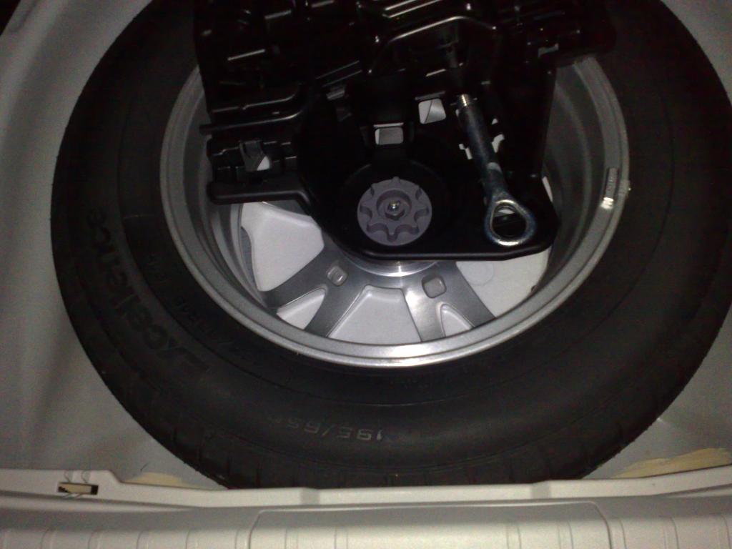

    So I went to do my once-every-couple-years maintenance check on my spare tire, and came across a problem.
    The spare tire is held in place in the wheel well with a bolt (that also holds the jack and wrench stuff in place). That bolt is connected to a circular plastic piece that is supposed to make turning/removing the bolt simple via the lug wrench. See image of the plastic star thingy here.
    Well, when I went to turn the plastic piece, it stripped off of the bolt. The plastic piece turns, but the actual bolt doesn't turn with it. I couldn't think of a way to conservatively work around this.
    I think my next step is just to try using a drill/bit extractor directly on the bolt, but that seems pretty high risk/nonrecoverable.
    Any other ideas/suggestions on how to get out the spare tire before I go this route?

    Try Vise-Grips first...

    Let air out of the tire and push downward on the wheel (maybe with a helper) to relieve the strain on the bolt, might be easier to release.

    Heat The plastic part with your heat gun now grab it with your large channel locks and remove the plastic now take your vice grips and insert them to the piece of metal that was spinning in the plastic take a shot of PB blaster with spray hose work it through one of the wheel slots to threaded hole let stand a few seconds now lefty Loosey the vise grips which are attached to the metal threaded rod Wella

    Maybe you got a water leak or a spill, corroded where the temp spare hold-down bolt threads in? Try to get some spray solvent (WD40 or what have you) on the connection, let it soak, then rap the head of the hold-down bolt (not the plastic surround) with a drift pin an mallet. Might help.
    taking air out of the tire may be impossible, with valve stem facing down.

    i second vice grips. it looks so pristine in there, hard to believe it stripped.
    makes the case for checking the spare more often i guess, and maybe you can grab a salvage part for replacement.

    I tried vice grips on the plastic handle to grab the bolt more strongly. No luck-- it just warped the plastic more and made it even easier to lose grip.
    As noted, I'm not really able to access the tire stem to deflate it, but I"m not sure it would help. There's enough give already that I'm able to turn/shake the tire (bolt doesn't turn with it though.). Likewise, I don't really have access to where the bolt goes into the trunk below to PB blaster it.
    The grip is destroyed enough at this point that knocking the bolt with a mallot won't help as there's really no way to turn it once I do.
    If I could somehow tear the plastic piece off, I could access the bolt directly with a socket wrench, but its unclear if I can really get it off without some kind of cutting tool.

    Some kind of heating tool might also work.

    Just cut away the plastic cap around the head of the hold down bolt with a vibrating cutting tool and remove the tire.
    Soak the bottom of the bolt with Liquid Wrench , where it is threaded into the hole and leave it there overnight.
    Take out the tire and grip the shank of the bolt with Vise Grips.
    Chase out the hole with an M8x1.25 tap or rethreaded tap.
    Get a new hold down bolt, and you're done.

    Before I would go with all that ridiculousness I would try s mapgas type torch because that often loosens stuff up quite well

    Where would you be applying the torch flame?
    To the painted body steel boss where the bolt threads in?
    If you can even reach there, with the wheel in place?

    I might try slipping a putty knife under the grey plastic flange and lining it up for a hard whack from a hammer.
    Then blast the grey plastic with an inverted computer duster spray can. A freeze spray; You are trying to make that plastic as cold and brittle as you can... then whack the butt of the putty knife handle with the hammer.

    You've already sacrificed the plastic by rotating it round and round and you're rounding out the square hole in the plastic correct something to that effect so now heat it with a heat gun better than a torch till the plastic is almost ready to melt and then lift up on it and pull it off that piece of metal now you can apply your vice grips and some PB blaster because you can get at and see the threads going down into the boss which is on a fitting which is welded to the center or the bottom of the trunk. If you ever get around to the junkyard you can get another gray plastic hold down assembly for free just put a little grease on it before you wump it in there.

    I'd make a stud out of M8x1.25 threaded stainless steel rod and tread it to the center a 3/8'x1' aluminum flat bar machined on a rotary table on a vertical mill with a lip to match the wheel's center hole.
    I'd lock the bottom into the bottom hole with a serrated flange nut.
    Grabbing the flat bar would allow one to tighten and untighten it like a large wing nut.

    large channelocks

    I think it already works kind of like a large wing nut now with a spacer and the ring to keep it centered if it would just have been kept with a little anti-seize on it this would have never happened I'm guessing that stuff works wonders or having a real full size spare and rotating it that rotation time will always keep that nut working
