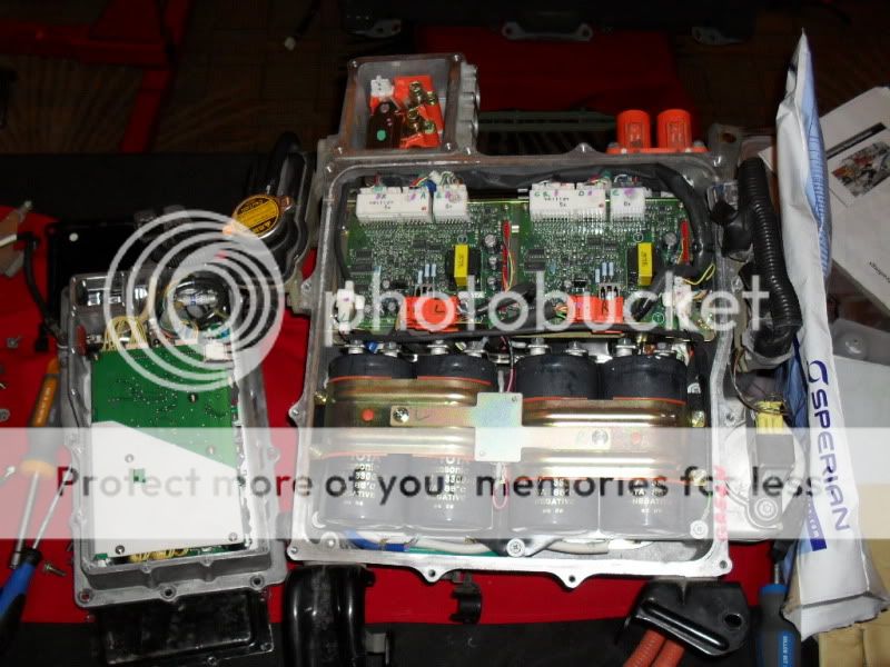

    Exactly what and why do you need to know about Prius capacitors? No "flux capacitor" or really any power related capacitors exist in the Prius other than some small filtering caps as shown in the pics above.

    Those are just filtering caps? I thought they were to act as a "buffer" for the battery for regen braking and acceleration?

    Modern high frequency switching power supplies and inverters don't rely on big capacitor banks like older linear power supplies did. This makes them smaller and importantly, more efficient. The following link describes the concepts. Think of the regen charging in a hybrid as an AC generator supplying a switching power supply to generate DC to charge the battery.

    Ok thanks. That will keep me from going on the complete wrong track. Again, I've been asking everywhere and haven't been able to find any specs on their inverter either. Everything seems to be on a "need to know basis" and not even the dealership needs to know these things. I suppose I could look at other 3300 uF capacitors on DigiKey and find out their specs such as frequency response , ECR, etc. I would still need to know what the actual frequency, current ratings, etc. are for the inverter though to know what to expect from the capacitors right?

    Yeah your right.....3300 uF is low. I'll post a pic of what I was looking at. I was looking at a pic that has 6 3300 uF caps. I'm not sure how they're wired though.
