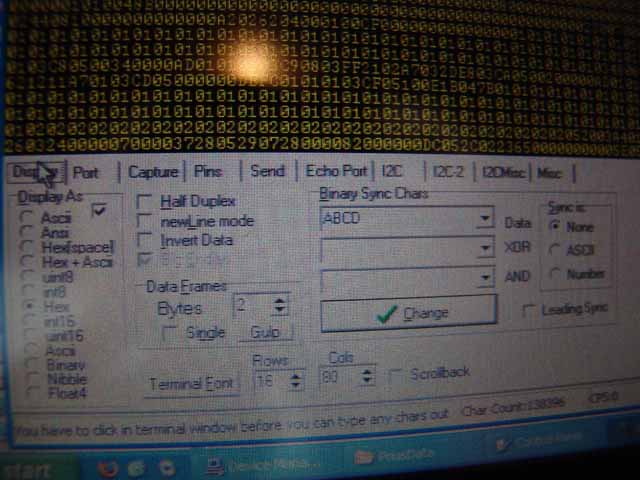

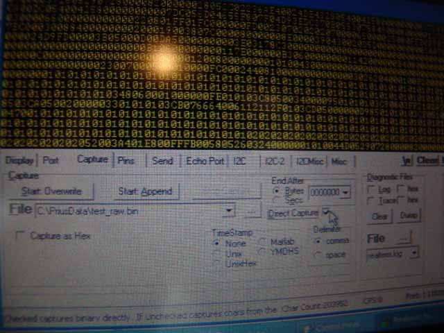

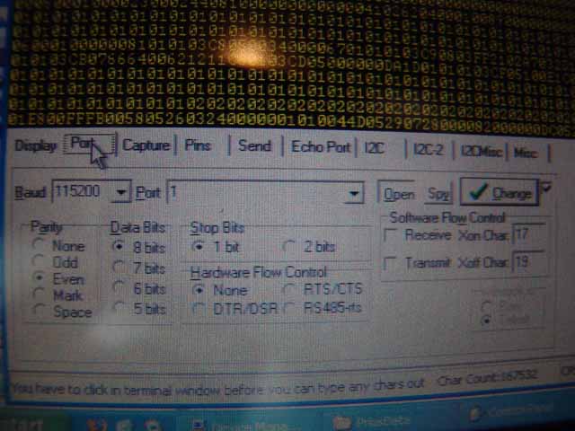

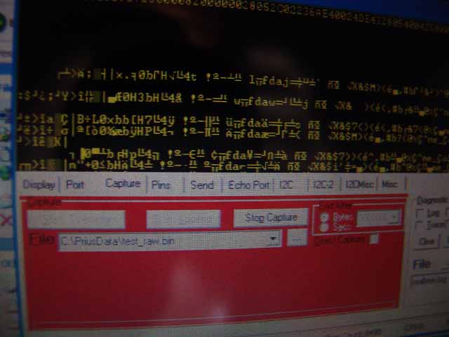

    OK I want to get this thing working this year. I tried to give it another go but failed to get any results. It is my understanding that with the RAW capture mode of the can-view I should be able to get about one line of data per second after converting the RAW data to a CVS right? Well I continue to only get a few lines of data after running the test for about 30 seconds. I will give you some screen shots of my settings and give you as much detail as possible. I did figure out how to get rid of the error light flashing. I had to set the parity to even.

    What I don't have is a pic of my OS port settings under device manager. I have it set to 115200, data bits 8, Parity Even, stop bits 1, no flow control.
    Here is the display screen. I have HEX set as display type. I dont think this really matters much on the capture side of things but I could be wrong.
    Port set at 115200, Parity even, data bit 8, stop bit 1, flow none.
    Capture screen set for direct capture. As you can see the display is displaying HEX.
    Here you can see that I unchecked direct capture so I could see what it was capturing. As you can see its a bunch of garbage compared to what i was getting before without capturing.
    I would like to note the receive light on realterm was flashing about once a second. From my understanding this one second burst contains one line of data when converted. Am I right on this? I have not bugged Norm in a while so I might send him this information to see what he thinks.
