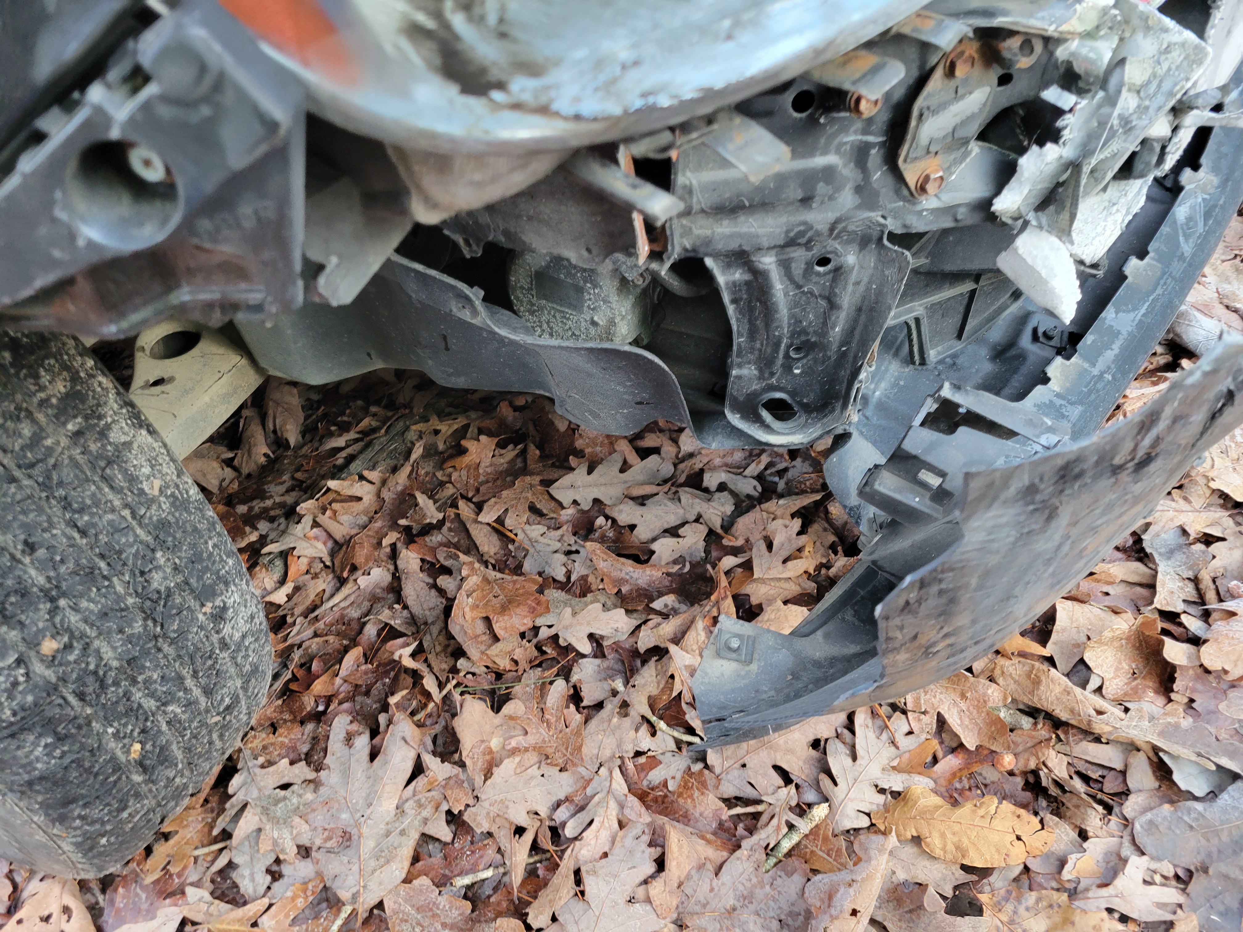

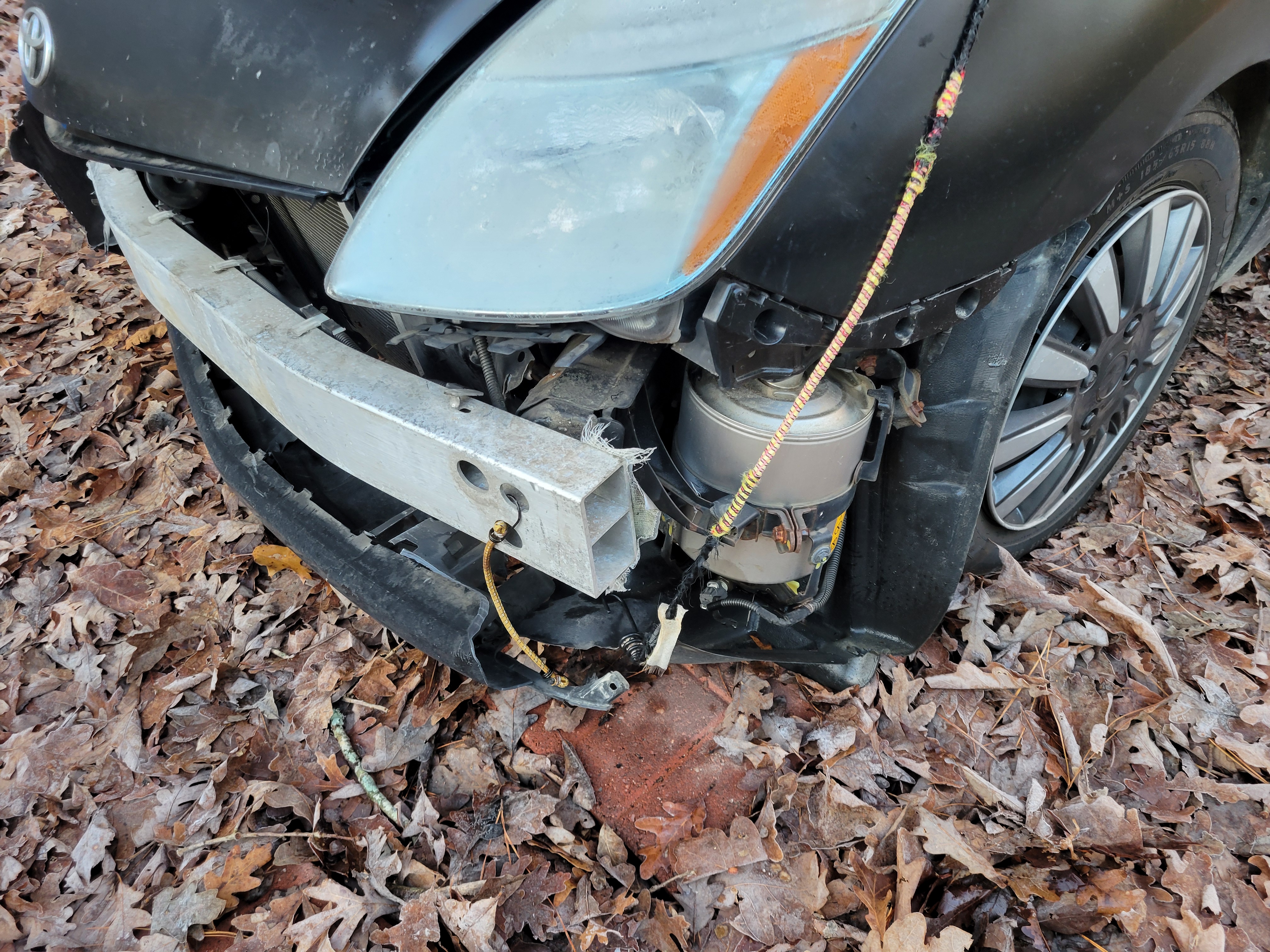

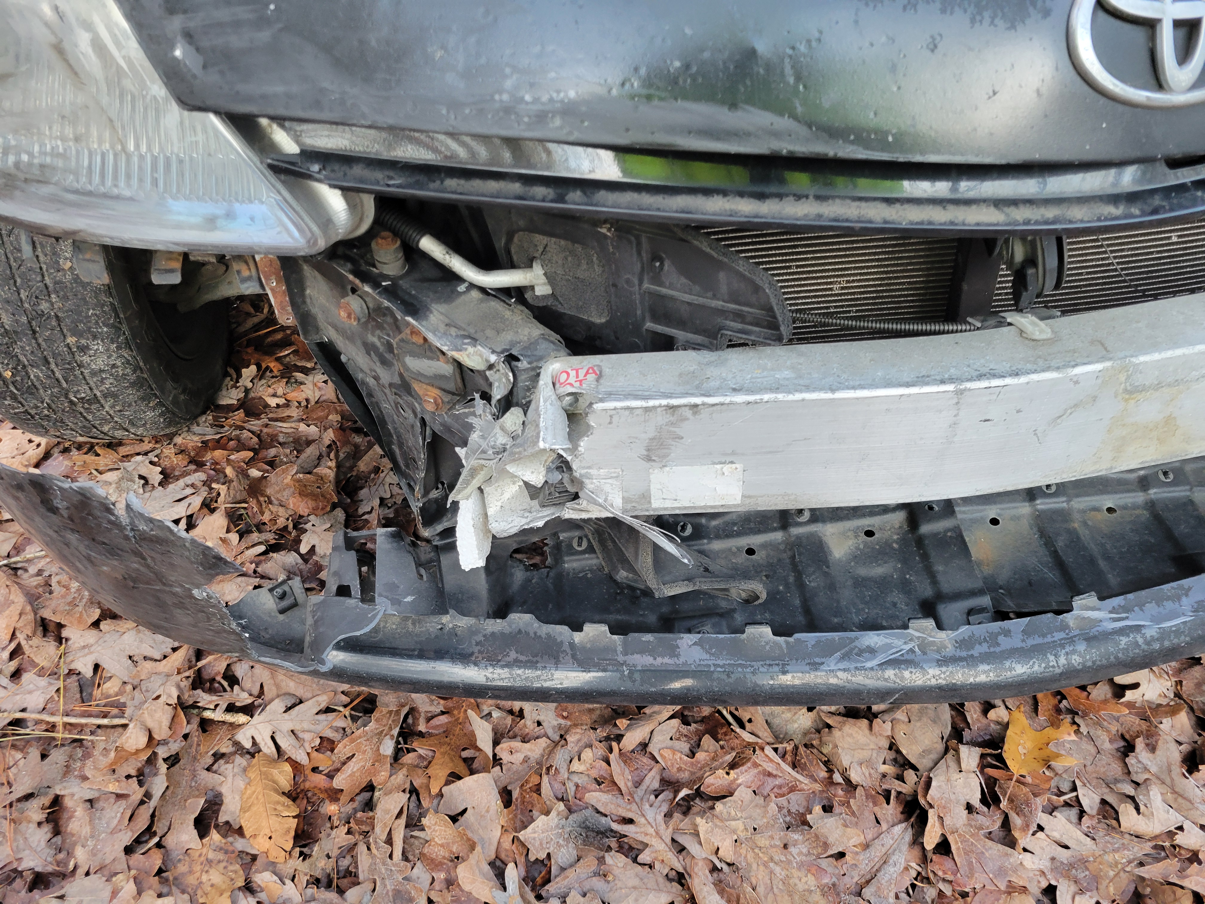

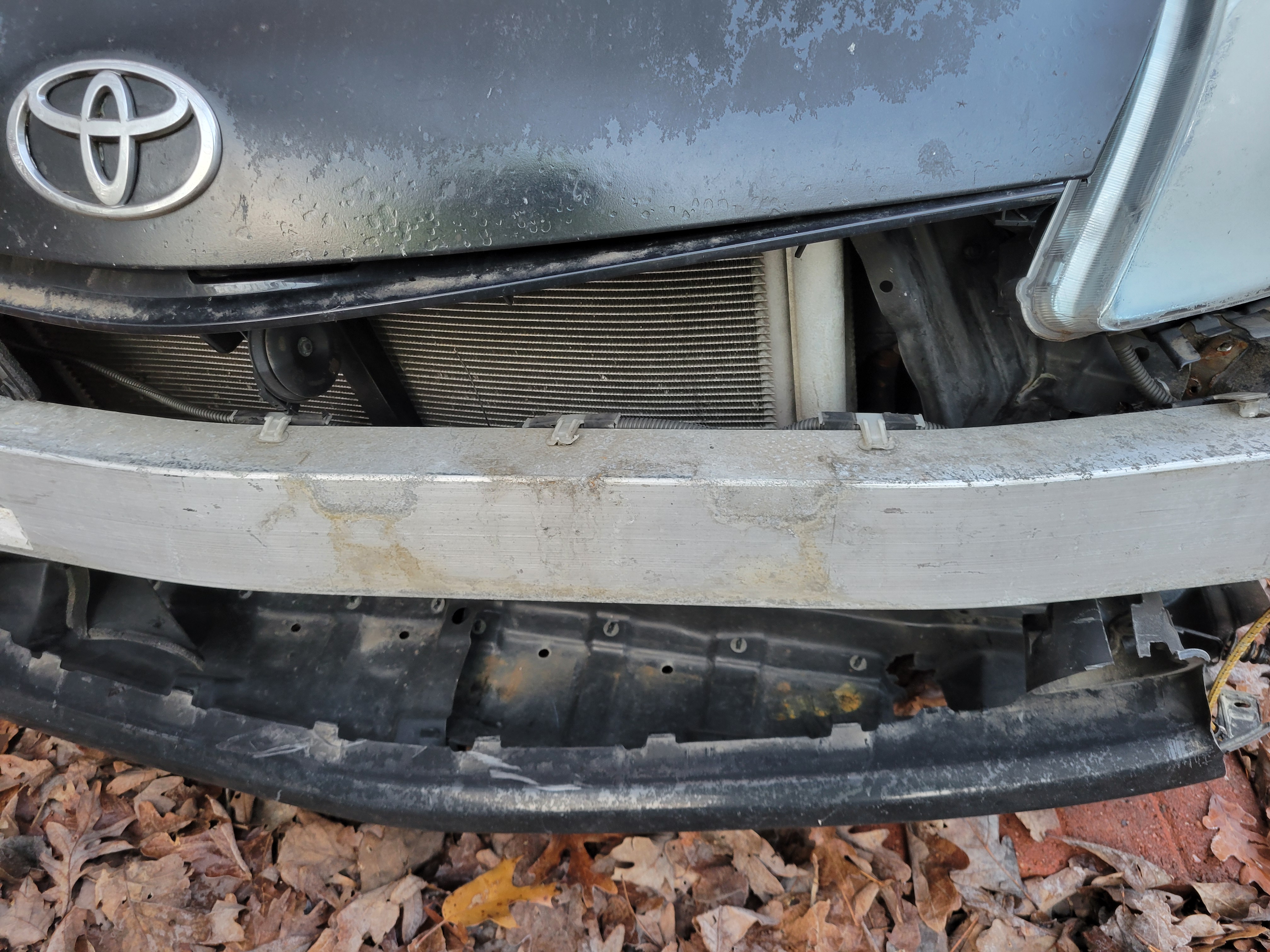

    I have a 2009 Prius and I was clipped last night and took some front end damage.
    Took some pictures and uploading a video to YouTube
    [​IMG] [​IMG]
    https://youtube.com/shorts/Q93tXu_kfW4?feature=share
    The car does drive straight because drove it for a short distance (several miles) but there is what looks like an anti-freeze leak on the driver's side. No airbag deployment. I was likely going less than 5 mph when it happened. Waiting on the insurance company right now as well.

    Yeah you can do anything you want to buddy It's your car I would say it looks like a lot of that is bolt on when you get the bolt on stuff off see what's bent stuff that doesn't bolt on that's bent generally these cars are pretty well built You can straighten them out right in the driveway may not look like brand new but hey you can buy a whole rolling chassis and move all your parts to the thing for $500 on up of course I know the idea here is to not spend anything and have your car back but you know those days are over for me kind of that's why I drive these old cars because I can get as many as I want for almost whatever I want to pay everybody should be able to when cars are this age.

    The biggest challenge is where the front metal bumper is bolted into place on the passenger side. If you can use a come along or winch to ensure those bolt holes line up with used replacement bumper the rest of the job should be fairly easy with just bending stuff back by hand and modifying failed fastener points to work again. I wouldn't spend much time or money on it till you're sure that those bumper bolts are taken care of.

    I don't know if the radiator has shifted as well an may no longer be straight or if it is an illusion.

    I'd write your first step is to remove the parts on the front end to clearly see the impact damage.
    That should answer the radiator shifting question and offer repair plan insights.

    The damage is peculiar. It looks like the OP's car was hammered straight in from the side right on the end of the bumper, but without touching the passenger side wheel, fender or headlight.
    It looks to me like the entire front bumper is shifted 6" to 12" towards the driver's side, and the two parts of the body to which it is bolted (frame horns?) are both bent 45 (?) degrees or so towards the driver's side. I looked in the repair manual and Toyota doesn't use the term "frame horn", and I couldn't find the appropriate section describing it. However, on EM-88 there is a diagram showing that component which looks like maybe it is bolted onto something rather than welded on. So if that is the case, and the thing it is bolted to is not also bent, which is a pretty big if, then perhaps both sides can just be unbolted from the car and parts from a junkyard bolted back on instead. I have no idea what squishy bits may have been damaged, but there is supposed to be a big white plastic thing sort of behind/under the passenger side headlight, and I don't see it. Resonator?
    Some pictures from underneath, looking up at the structural components would help. That said, I suspect that there is too much front end damage to justify trying to repair this. The car is likely "J shaped" now, with the big offsets we can see, but smaller ones farther back. Perhaps a body shop would give you an analysis of the damage for not too much money?
