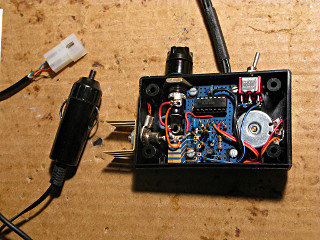

    There is also an article by hobbit about a little circuit he built to interface with the car's blower controller and run just the blower at a low (less than one amp) rate for sleeping ventilation with the rest of the car off.
    His article is about a Gen 2, but the Gen 3 blower speed is similarly controlled by a duty-cycle input you can generate. The photos from hobbit show the Gen 2 blower motor controller, which was a separate box mounted in the air duct (and people would sometimes call it the "resistor", because in older cars with blower motor resistors, they'd be mounted that way too).
    Gen 3 just uses a blower motor that has that controller built into it and no separate box, but the idea is completely the same.
    Gen 3 cars with the solar ventilation option come with a brushless version of the blower motor, others got a version with brushes. As far as I know, they're interchangeable, have the same pinouts, and work the same way, but the brushless one will last longer, for expecting lots of extra hours of runtime.
