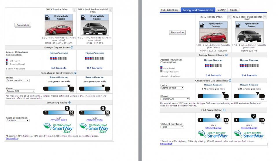

  9. Jonny Zero
    Jonny Zero Giggidy
    Jun 22, 2012
    1,388
    352
    Austin, TX
    I have been researching this since the Hawaiian Thread. Seems both Ford and Toyota carry different certifications for CA and TX. See the screen grab from Fueleconomy.gov.
    I have no idea if the Prii are built the same, just "certify" differently for legal purposes.
    CARB states get PZEV certification, and everyone else gets Bin 3.

  11. wjtracy
    wjtracy Senior Member
    Sep 19, 2006
    11,374
    3,609
    Northern VA (NoVA)
    Yes I agree with you I don't undertand those designations, but I think Trollbait understands that stuff if he sees this please advise. He basically says if you order a Prius there is only one car to order. If you look at EPA fueleconomy.gov site I believe yes FORD has non-CARB versions listed, possibly with different MPG ratings, I cannot recall.

  14. Trollbait
    23,716
    12,805
    Under the emission rating on the attachment and Fueleconomy.gov site is the engine code. This designates what engine and emission equipment the car has. The Prius and the Ford have the same engine code regardless of which state. So the one bought in Texas has the same equipment as the one bought in California. The different certifications, if they are actually different, are for warranty and other financial reasons. CARB and the feds have different labels for emission ratings. IRRC, bin 3 and PZEV are close in actual emission limits.
    Lean mixes burn hotter, and full throttle usually enrichens the mix for extra cylinder cooling. The rich mix at start up is most likely to reduce NOx emissions.
    As to the OP, has others have stated, you need to get the car to warm quicker in order to improve fuel economy. Otherwise the Prius will spend most of the trip in the warm up cycle. A block heater is the best method. For a lower investment, I used a cardboard grill block with some insulation placed around the engine with cars in the past.
