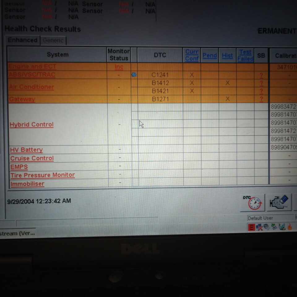

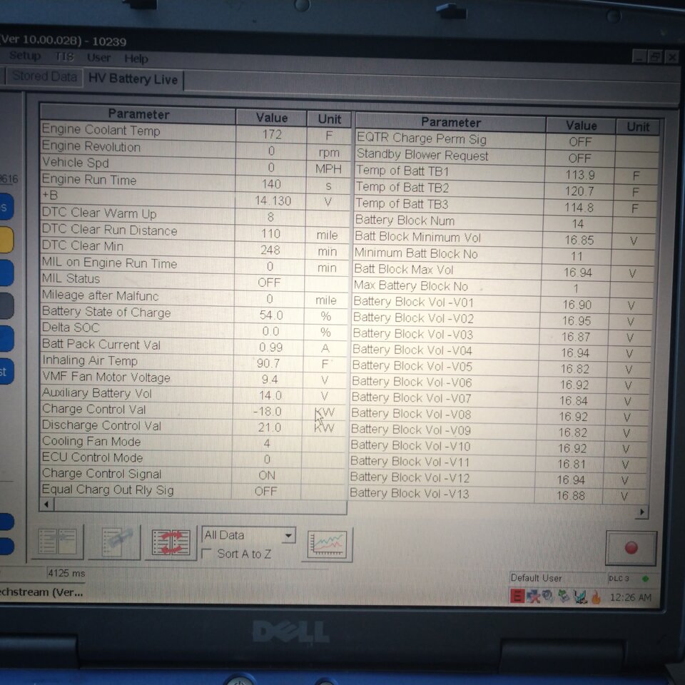

    Get trailer, get car and connect Techstream. Techstream show no reason for what happened. See pics. BatteryLive.jpg Codes.jpg Never mind the date in TS, laptop battery is dead and I never set the time.

    Good 12v and HV batteries, so dont go there.

    My first guess is your hybrid battery is running hot and you might have a hot cell that's about to fail and tech stream didn't catch it because its since cooled and no longer giving bad readings.

    That is my normal startup procedure. If the battery was overheated, should have thrown a code. The battery fan is clean and does work. The CM was/is working at the moment. I know if the CM was not working there would be NO lights at failure time and car would appear to be simply off and dead coasting to a stop. Once "reset", it can work for several days to a week or so. It will decide to go out a any random time.

    Once you get to 2010 Prius and newer you can say the codes would be there... But with Gen1 and Gen2 the system is pretty pathetic and a code can arrive and vanish before you get a chance to catch it.
    If I were you, I'd watch Dr. Prius app as you drive and monitor voltage difference and pack temps... I bet your problem shows up during a high amp load with high voltage difference or at peak battery temperature.

    As I understand it, the freeze frame function on an OBD II code reader will look at the last entries for the entire system. So, after a failure, this function (as I understand it) should display all codes recorded for the last system failure. Of course, if the 12 v battery was removed, this data could be lost. So, use this function after the failure but before disconnecting the battery.
    I noticed on the display with the DTC's - all are related to the HV hybrid system (there are other lists but this is in common with all codes.) Could the AC compressor be shorting into the system ground? Guessing here but appears some things are seeing high voltage (like the ABS system code.)

    Are you referring to the calibration codes in the far right? I don"t know what they mean, but if there was some error, I would expect it to show under DTC. The AC compressor shorting? Don"t know. I could unplug it and ohm it out, or next time trying to start the engine, I will leave it unplugged.

    There are no codes for the "HV hybrid system". The numbers in the calibration column just inform the software version of the applicable ECU.
    The "ABS system code" is about the voltage arriving at the ABS ECU.
    The Air Conditioner codes do not implicate the compressor. There is no need to guess; a quick check of the repair manual will show that one code (B1412) is about the ambient temperature sensor. The ambient temperature sensor is installed in the front part of the condenser to detect the ambient temperature and control the heater and air conditioner "AUTO" function.
    The other AC code (B1421) is about the solar sensor. If the code was pulled when the car was not in bright sunlight, this code tells you that, and if that was the case, then move on; nothing to see here.
    The B1271 tells you what is already known—the combination meter is not working—so there is a Combination Meter ECU Communication Stop

    Thats what TS detail told me but I'm open to everything at this point. Batteries are on slow chargers and a good thorough look-see under the hood found nothing loose, worn or eaten. Gonna jack up the front and get underneath tomorrow.

    Are you sure there's no error codes? You have all kinds of problems and for there to be nothing telling what's wrong tells me your diagnostic tools aren't working. Either the car's ability to log codes or your gears ability to read codes. I mean there's an error code for when the engine won't start, an error code for when the engine has low power and so many others. If I were you I'd diagnose why you can't get error codes before you worry about why the car won't run. Either your 12v is malfunctioning or one of the ECUs.

    Not getting any codes (but power to the OBDII) could be the reader as just posted or maybe the interface is compromised - obviously the fuse is good or the ODBII reader wouldn't power on.
    My earlier post was made since I wondered that if the AC compressor was causing some HV to leak to the frame, the ground connections would be compromise. That, I wondered, might be the issue for those other items on your list. The car should then prevent starting if it thinks the HV system is compromised.
    Yes, just guessing but your issue is a difficult one.
