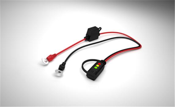

    Condition Monitoring Pigtail.jpg We use a CTEK MULTI US 7002 battery manager (p/n 56-353) and have CTEK battery condition LED indicator pigtails (p/n 56-382) permanently connected to the AGM battery terminals on the cars and inverter genset, making access to the visual condition indicator easy, and charging (if required, on condition) as simple as "plug and play".
    CTEK Power Multi US 7002 Battery Chargers 56-353 - Free Shipping on Orders Over $99 at Summit Racing
    CTEK Power Comfort Connect Indicators 56-382 - Free Shipping on Orders Over $99 at Summit Racing

    Thanks for the quick and thorough information, as our trip is coming up soon. I purchased this AM a Genius Charger G3500. I also picked up the pigtail (as mentioned above) part name GC015. It has been attached to the battery in the back. It has 4 numeric indicator positions. It is currently in the 75% amount. I am testing the G3500 on some older 12v batteries which I use for the Christmas parades to power my lights on bike and trailer. Should I be worried about the pigtail indicating 75%? I am leaving in a couple of days and will be garaging car and plugging in G3500. BTW is this a reason why I am only getting 5.2l with summer tires?
