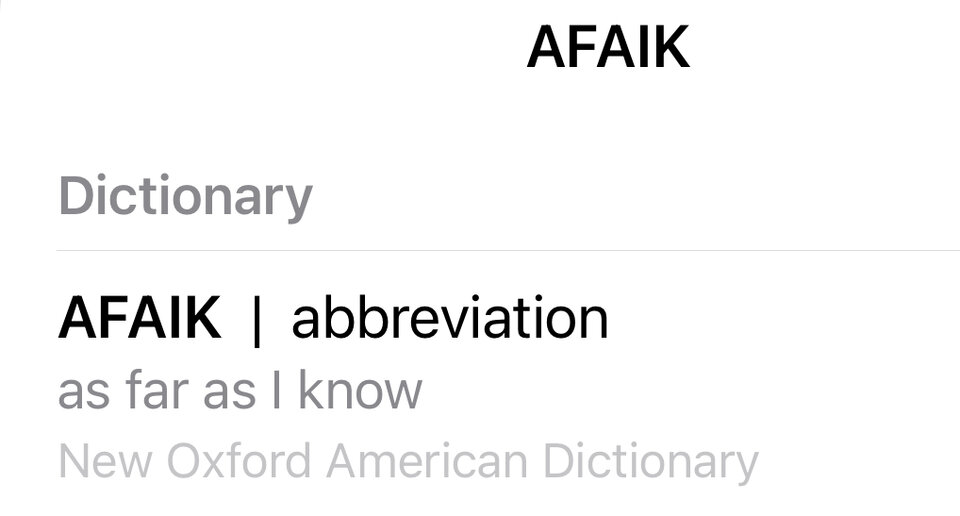

    What does AFAIK mean? Thanks, John Ross
  9. rjparker
    rjparker Tu Humilde Sirviente
    Jun 6, 2008
    11,009
    6,898
    Texas Hill Country
    Google is your friend
