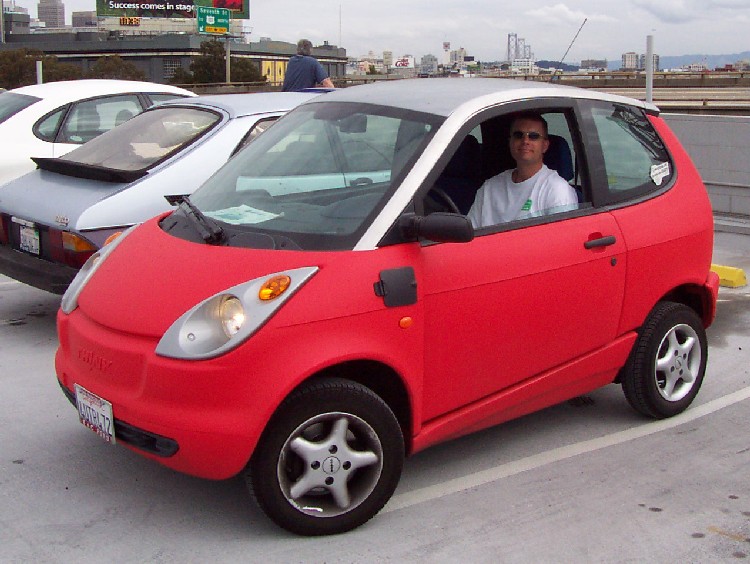

    In norway , we got 4 Prius hydrogen hybrids in the Stavanger city total of 15 ordered i think).Mazda had a RX8 hydrogen democar there. This is more like a test of the hydrogen part .
    The Priuses are made Hydrogen usable by "Quantum(or Quantem?) in Lake Forest i California"
    so far the cars havent been used too much , some newspapers say there have already been problems with the hydrogen part of the system due to cold weather , and its not really cold here yet........there was some critical writing about it in som newspaper and th Q company reacted agressive lol.....
    another challenge is the making of hydrogen from naturalgass from the bottom layers under the northsea (cause is that its the cheapest way of doing it ), this causes alot of CO2 so you basically dont reduce the CO2 but move it instead.
    actually the test taxis we have here that runs on Hytan looks good so far. could be and interesting part of the evolution,,, but I suspect the hydrogen spirit is the selling and political correct/smart atm.....
    else we have the Think company here that makes small Evs and they are now working on a hydrogen-electric version. hydrogen and el plugin, hydrogen fuelcell.. expected 250km range (think the demo version already been used)
    http://www.think.no/ ive tested the "old" Think city car and it was a positive suprise even that it is a small car... so if the new Think city is better , then it should be a fun small car. Range of these cars are limitied by the battery thech tho... and for the pollution part most of the el power in Norway are made by Hydro electric powerplants...

    The Th!ink is a fantastic little car that I'd love to own! In fact, here's me in one that was shipped back to Norway instead of being crushed by Ford here. Way better than the GEM NEVs.
