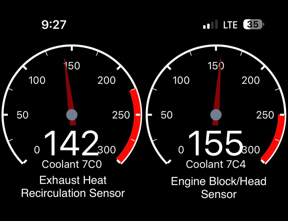

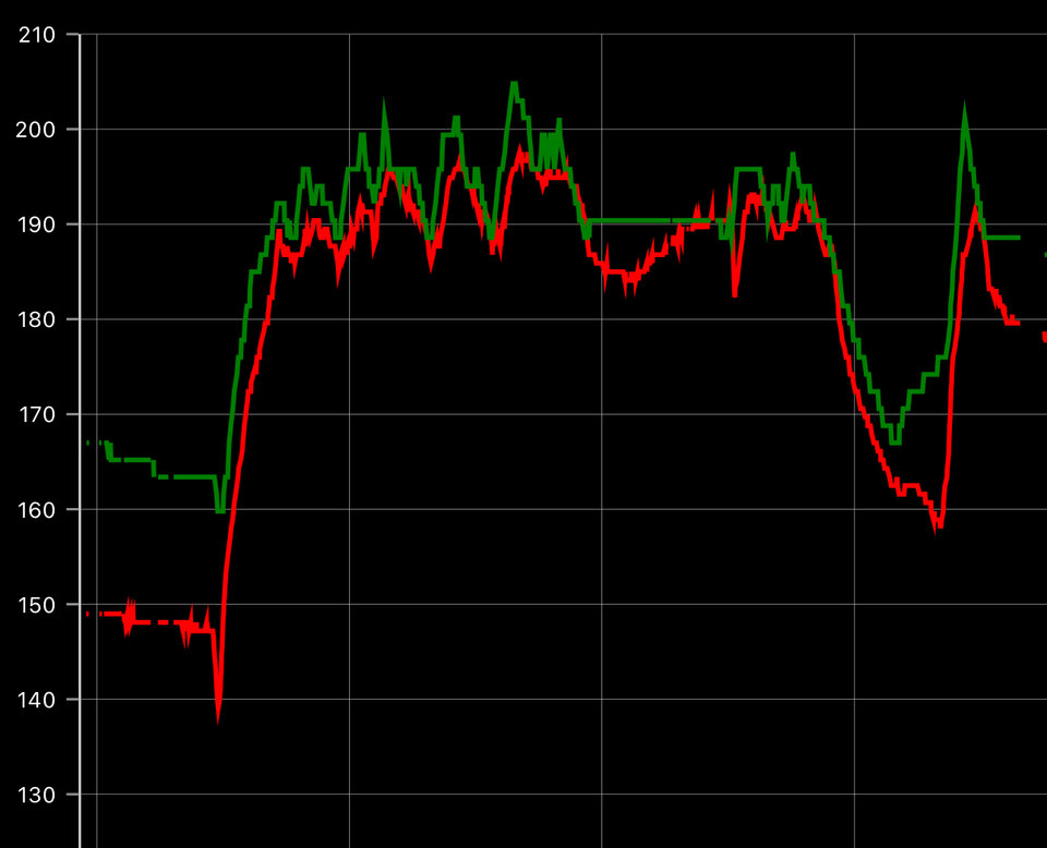

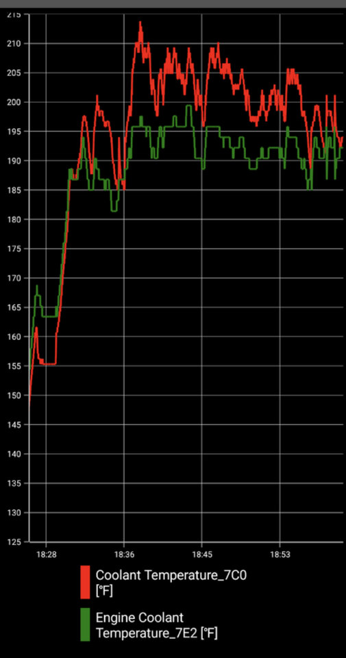

    Car Scanner coolant temp diagnostic aids
    Stuck Exhaust heat Recirc valve coolant temperature sensor in red
    Good exhaust recirc valve
    mjoo, xliderider and Brian1954 like this.

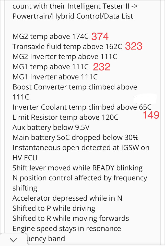

    Is there somewhere to get all the temperature RED limit pointers for Gen 3?
  10. rjparker
    rjparker Tu Humilde Sirviente
    Jun 6, 2008
    10,622
    6,658
    Texas Hill Country
    The alarm limits are in the repair "manual".
    Portion
    Engine coolant temp is 248f.
    I setup separate temperature alarms lower than the vehicle's.
    A.J likes this.
