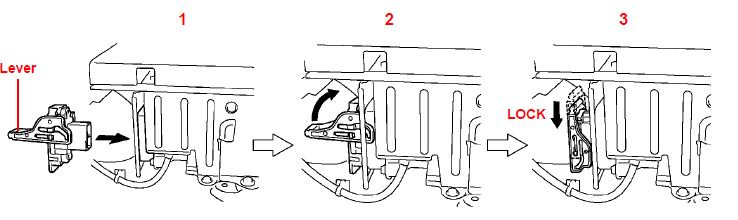

  8. JC91006
    JC91006 Senior Member
    Nov 10, 2013
    16,931
    8,640
  9. Buckinghambob
    Buckinghambob Junior Member
    Sep 26, 2019
    23
    Virginia
    Thank you, thank you for that diagram, I didn't remember to push down, car went to ready, and shifted, going to test drive now,
    thank you, thank you, thank you

  11. Buckinghambob
    Sep 26, 2019
    23
    Virginia
    seeing the battery level indicator gave me a false impression it was connected, evidently just enough for sensors to read voltage, but not the strong connection needed to engage the battery.
    I was so sure I had done it right, I just didn't do it far enough, funny how that simple act of pushing down could make such a difference.
    Thanks again.
    Btw all the warnings cleared, and normal functions on a short test drive, probably take it about 50 miles later today to get an idea about mpg and actual functionality of the new modules.

  12. ChapmanF
    28,612
    18,947
    The high current connection to the battery was just fine. There is a separate, low-voltage, safety interlock circuit that runs through several safety covers in the car, including that switch, to lock things out whenever any of that is open, and avoid killing you. Pushing that handle down is what closes that safety circuit.
    If you had read the trouble codes, there would have been one for the interlock circuit, answer in one step.
