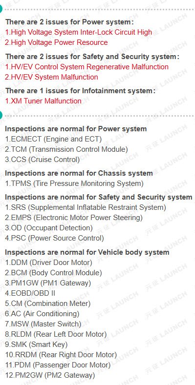

    When I parked my 2010 Prius Saturday, it ran fine-no warning lights. This A M, all the dash lights were on with a message,"Check hybrid system". The yellow triangle light was on. I am disappointed that it gave me no notice or warning ahead of time. The 12 v battery measures 12.5 volts. I plugged in my OBD2. It has the free version of Dr Prius. It shows 220 volts and 11.66 volts for the 12 volt system. My Creader shows "High voltage interlock circuit high" and "High voltage power resource" (I removed the orange safety plug, but I put it back in and locked it) It also reported "HV/EV Control system regenerative malfunction" and "HV/EV system malfunction". The regenerative malfunction is disturbing. I replaced two expensive parts in the brakes 2 years ago. The brake fluid reservoir is full. 2025-10-06_9-57-23.jpg 2025-10-06_9-58-50.jpg

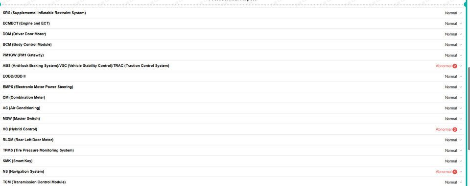

    Are those screenshots from CReader? I'm disappointed that they only show code descriptions and not the actual codes. Is there a way you can get it to show the codes?
    Some of the codes we see often enough to recognize anyway. The "High Voltage System Interlock Circuit High" is definitely P0A0D, for example. The "HV/EV Control System Regenerative Malfunction" and "HV/EV System Malfunction" are probably C1259 and C1310 (or the other way around, which doesn't matter much 'cause they're usually together and mean pretty much the same thing).
    But it's always better to be sure the actual codes are in your post, so it doesn't start off as a flash-card quiz for the people trying to help you.
    The C1259 and C1310 don't mean anything you have to worry about with the brakes. Those codes are just the brake system telling you it knows there are hybrid-system codes. (It has to know that, because to do regen the brake system has to depend on the hybrid system doing its part.) Those codes will go away once you've got the hybrid-system codes dealt with.
    At what place in the story did that happen? Disturbing that plug is the most common way people give themselves a P0A0D code. That's not a code that often pops up unprovoked.

    Yes. The codes are P0A0D, P3004 and C1259, C1310
