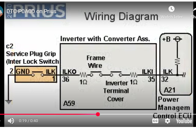

    Maybe I read a post with incorrect info. I did find a schematic that I can use to trace down the true meaning of the code. 2025-10-06_20-21-21.jpg 2025-10-06_20-21-21.jpg

    Chapman, The simplified electrical diagram of the interlock circuit did not work for me. I did not understand, "frame wire" and it left out some connectors for simplicity. And I did not know which connector was A59, or pin 36. The wire colors were not shown. I do not know where the power management control ECU is. I decided to have a tow truck come to get it.

    I'm sorry to hear that. Yeah, the unsimplified wiring diagram has all that information.
    Toyota Service Information and Where To Find It | PriusChat
    The online version is especially cool: you can just click a part of the circuit and the whole circuit is highlighted and you can follow it around.
