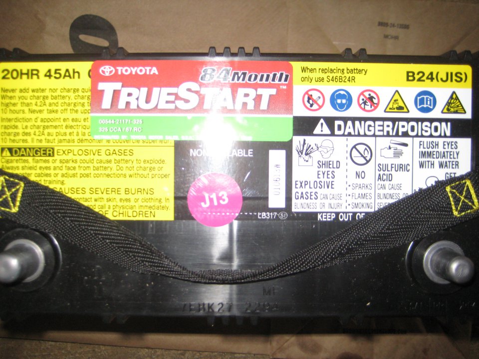

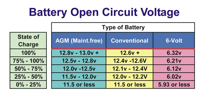

    JOL,
    Coming in late on this thread. You only need two sockets, two wrenches, and a screw driver. You don't need to buy a set of tools. Look in my signature file below this post. Click on the second link and read post #8 in that string. It tells you everything you need to know on how to change the 12 volt battery in a Gen II Prius. Your 2010 is a Gen III, which is even easier to change since you don't have to deal with the plastic duct like the Gen II. Just loosen the battery clamps, remove the negative first and reconnect it last, and take the hold down bracket off of the battery...
    Go to Sears and buy some "Craftsmen" brand tools. They are guaranteed for life.
    I did it with NO problem. It took me one hour to do the job. I worked slowly and methodically. Experienced guys can do the job in 15 minutes easily.
    Don't pay the dealer the outrageous price for the labor to put it in. DO go to the dealer and buy a ORIGINAL OEM battery. The Yellow Top's are hit and miss. The Bosch doesn't have the right posts.
    Make certain what ever battery you put in is FULLY charged. A fully charged AGM type battery will measure 12.9 volts or HIGHER with a digital volt meter at the posts with NO load.

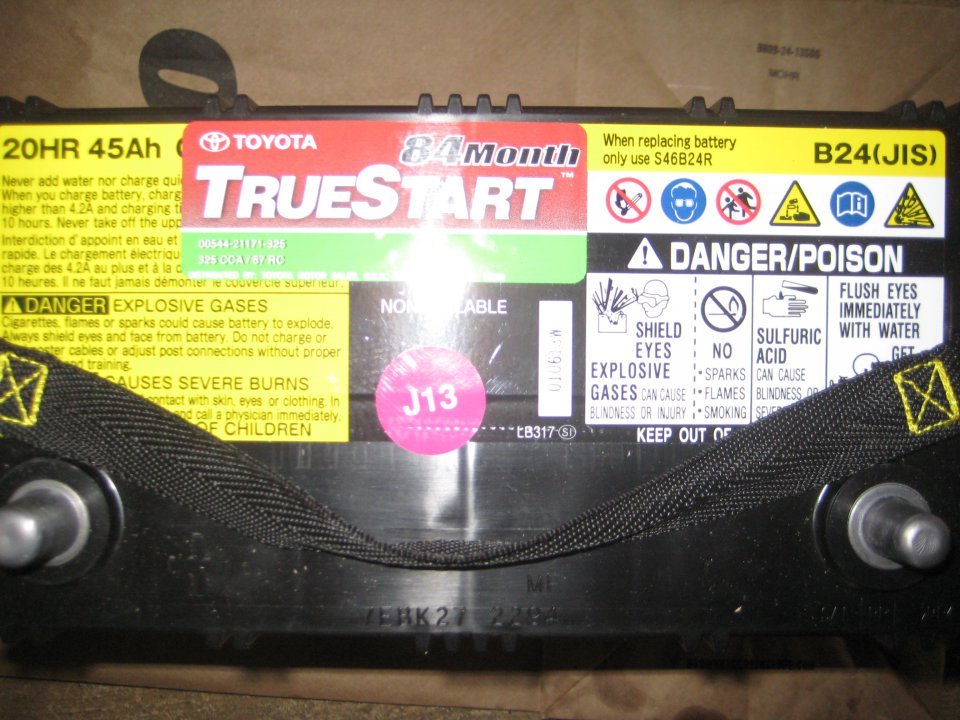

  14. dorunron
    dorunron Senior Member
    Jul 17, 2011
    3,318
    1,105
    Houston, TX
    What bisco said...
    Just hook up a portable start pack to the Jump Post on the Prius. Make sure you have a solid connection on both terminals of the pack. If you don't have that, use a old 12 volt battery that is fully charged. Even two NEW 6 volt lantern batteries wired together in series is enough power to keep the Prius alive while you are swapping out the battery.
    Then unhook the negative cable FIRST on the battery. Sometimes easier to disconnect the cable from the frame and remove it after the battery is out of the car. Put something over the terminal ends of the cables as you disconnect them from the battery. This is very important on the positive cable since it will have 12 volts of DC current on that cable. You do not want to accidentally touch any metal surface or any grounded item with the positive cable when it is energized. Some people put black tape on them, others might put a leather glove. Main thing is to INSULATE the HOT cables so nothing stupid happens. Once you get the new battery in place, hook up the positive cable FIRST, and then hook up the negative cable LAST. After that, remove the jump pack from the jump post and the ground and everything should be good to go.
    FWIW, Beware of the Yellow Top. Several posts recently about folks having to replace recently purchased yellow tops due to not holding a charge after a years worth of use. They may be cheaper, but are they really worth it. Also compare the amp/hr rating of BOTH batteries. You will find the OEM battery has more power in it. I recommend the OEM battery which is shown below that can be purchased are your local Toyota parts counter.

    FWIW, the average lifetime of any battery is 3 to 5 years. One of the main reasons why the Prius 12 volt battery lasts as long as it does in some cases is because of the low current draw on said battery. All batteries have a given amount of charge/discharge cycles. This includes the traction battery in the Prius and the 12 volt battery.
    I am not a bandwagon pusher or anything like that. I speak from experience and my knowledge of electrical devices, batteries, and the units they are used in.
    As I said earlier, there have been several posts here on Prius Chat that have discussed the Optima Yellow Top failing within one years time. It seems that the change in the quality coincides with the closing of the main plant where the yellow top was being manufactured. The yellow top is now being manufactured south of the border in Mexico. According to Optima Jim, all QC is still in it's place and that the Yellow Top is still the best battery out there. However, look closely at the Yellow Top Specifications. Note that the Amp/Hr. Rating is less than the Yuasa Brand OEM Battery is.
    Yellow Top 39 Amp/Hr.
    Yuasa 45 Amp/Hr.
    6 Amp/Hr. difference might not seem like much, but in reality it could make all the difference in the world if you happen to leave an interior light on and then remember it before the battery is discharged enough to cause a no start scenario. Face it guys and gals, Toyota gave us a wimpy battery to begin with. It is sufficient, but could be much larger with more capacity. However the space for the battery is limited due to the engineering of said Prius.
    Furthermore, due to the structure of batteries including AGM type batteries, once you have seriously discharged your battery it no longer will have the lifespan of a new battery. It will also not hold a charge as well as not fully recharge to full voltage which should be a minimum of 12.9 volts with NO load when measured at the battery post's.
    Most batteries die a slow death due to sulfation. All liquid type batteries suffer from this. The one thing that really helps with the sulfation aspect is to keep the battery "fully charged" as much as possible. It is well known that the Prius charging system is not the most robust thing on the planet. Quite a few here recommend topping off the battery on a regular basis with a smart charger.
    In reference to sitting at the dealer while you wait for them to change your battery, chances are those type could care less about the brand of battery or any thing else. Those type are generally the one's who also NEVER check their oil with the dipstick and then cry when their Prius suddenly burns oil. It really is all about knowledge and maintenance. A lot of folks never look under their hood. All they do is put gas in her, and take it in when they think about it to get the oil changed if they even do that. Now, if you don't have the tools or the knowledge to change that battery anyone can purchase the small handful of tools that are needed to do the job. And instructions have been posted several times by many including myself on how to change the 12 volt battery.
    Finally, the current battery being sold by Toyota for the Prius comes with a 84 month warranty. The Yellow Top's warranty is a lot less. For the first 3.5 years the battery is FREE from Toyota if it is found to be defective. After that period for the remaining 3.5 years the price of a replacement battery is 50% of the cost of the new battery. Those specs. are verbatim to the "TrueStart" battery for the Prius pictured below.
    I challenge you to look at the Yellow Top closely. Compare the "warranty" and the "amp/hr." rating. And then remember that all batteries have a limited amount of charge/discharge cycles. A lot depends on how you maintain your battery and your Prius as to how well the Prius will be there for you when you need it.
    Ron (dorunron)
