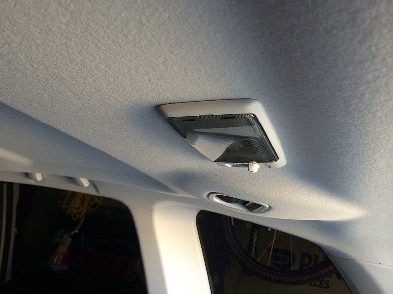

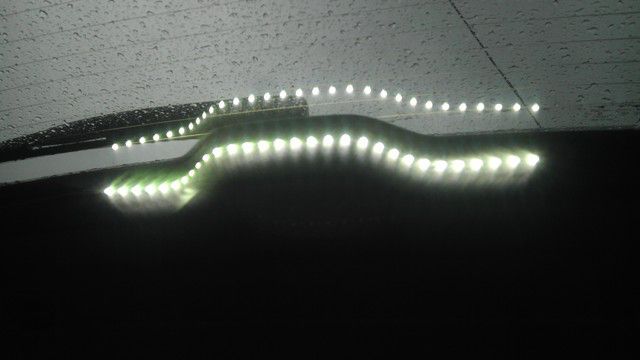

    I'm wondering if anyone has installed an additional light fixture in the cargo area. I've seen lots of threads on replacing the bulb in the existing (too-low-mounted) fixture on the side, but I'm really interested in something that lights from above so it's actually useful when there's cargo in the cargo area. I searched as much as I could, but I seem to have trouble with PC's search function... I couldn't find anything at all in the v forum, and this was the only relevant thread I could find where someone did a fairly clean install of an LED strip integrated into the existing lighting in a GenII. Am I missing something?
    I've seen a few good ideas on a Subaru Forester forum:
    Additional dome light fixture
    LED strip mounted on hatch
    (Photos are from the linked threads)
    I especially like the first one, with the very clean-looking install in an OEM fixture.
    Has anyone done anything like this in a v? Are there any wires to watch out for behind the headliner? Any tips on removing the rear trim around the headliner? Any ideas where I might find an OEM dome light fixture to match a "Bisque" v interior?
    TIA!

    Thanks for the link! However, I am hoping for something with a switch, just like the existing center dome light. I'd like to have the option for it to be on when the hatch is open, or off altogether. In fact, I just want another one of the center dome light fixtures, but I can't find a source or even a part number. I'm not talking about the double map light up front, but the single dome light above the 2nd-row seat.
    Anyone have a part number for that? Or I might try to find one in a scrap yard, as long as the interior color matches.
    Then I'll have to figure out whether to wire into the existing cargo light, or fish up to the center dome light. Fun!

    The hatch-mounted fixtures look interesting, but these barely-English listings make me more than a little hesitant to buy them. I'm not sure what I'd actually be getting - there are pictures of translucent LED covers surrounded by gray plastic frames, and also transparent LED covers with no gray frame. There are also pictures of both the v and the non-v.
    Has anyone ordered these and installed them on the v? Which style of fixture is included, and how does it fit in the hatch on the v? If these were $20 or so, I'd probably order it to give it a try. But for $78 after shipping, I'm not going to chance it until I see for sure what I'd be getting and how it'd fit.
    Also, the tilt switch looks interesting, but at 80mA, I doubt it'd be sufficient to control multiple or high-power LEDs like I had in mind. I think I'd rather have something that was on the same switch as the dome light, with the option to turn it off altogether.
    I'm going to try installing the one on my Forester first, and see how it goes. If it works well, and if the color of the dome light housing works well enough with the v's headliner, I'll just order another one of those.

    If I can find a dome light fixture/housing that is a suitable match, definitely! Check out this thread from a Subaru forum. Looks to me like the cleanest, "OEM-est" solution. A strip of LEDs on the hatch would be quicker, and would probably work just fine, but I'd rather have the extra dome light if possible.
