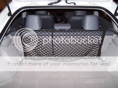

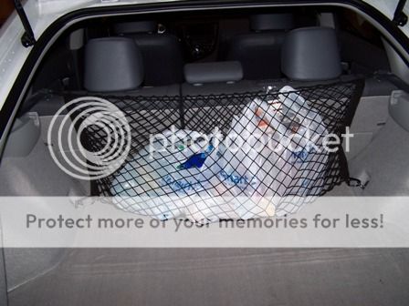

    I hang the cargo net off the back of the rear seat where it is not in the way. I reused the cargo net from my 2007 Camry. To install, snap the top loops of the net into the seat belt guides on the top of the back seat. Use small D-rings to connect the bottom loops of the cargo net to the cargo tie-down rings on the cargo floor. Works like charm, is out of the way and actually looks cool. You do have to disconnect the top loops from the back seat when folding down the back seat, which is easy to do and for me is not often.
    Here are pictures of my cargo net empty and with items:
