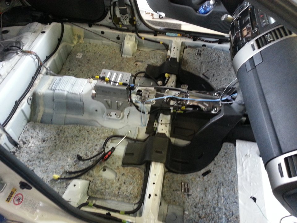

    You're now ready to remove the carpet. First, slide the fuel level through its hole in the carpet (rotate it 90° to get it out). Then the carpet should lift out. There will be additional padding below the carpet that is not tacked down--these are the "silencers". I recommend lightly vacuuming the floor of the vehicle and then you're ready to proceed with installation.
    Here's a photo with the carpet removed:
    (the blue and gray cables running down the center are for my two-way radio)
