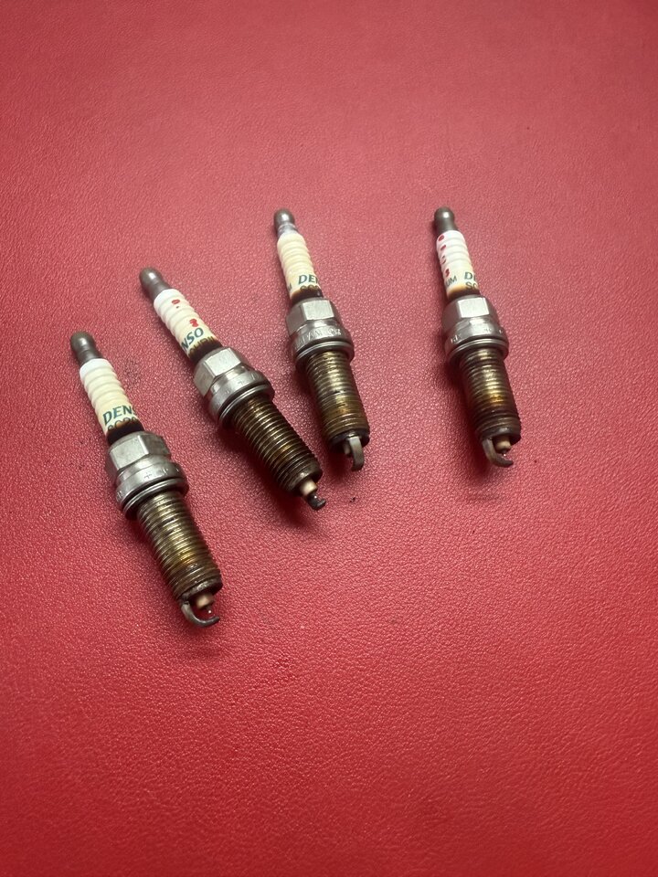

    So I took my car in to a shop to have the cylinders borescoped.
    The shop told me they didn’t see any sign of head gasket failure but they pulled my spark plugs and told me that was likely the problem.
    I attached a picture of the spark plugs.
    This car has 80,000 miles. Do these spark plugs look normal, or?
    Definitely going to try to change that first to see if it’ll fix my problem.
  20. ASRDogman
    ASRDogman Senior Member
    May 29, 2018
    7,996
    4,058
    Hard to tell from that photo. Need close ups ...
