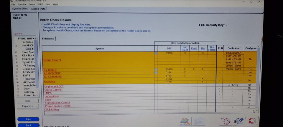

    If the dealer takes their laptop, which they have, and they plug it into your car, and they click the ever-lovin' Health Check button in Techstream, which they have, the screen that comes back staring them in the face looks like this:
    (The example, of course, came from somebody's thread where the car has a bunch of trouble codes. Never mind those.)
    If they then look in the column that says Calibration at the top, in the row that says Engine and ECT at the left, in this example screenshot the calibration ID is 34712100. Right?
    Now, according to T-SB-0027-16, which was the one about the newer EGR valve, if they installed the firmware update mentioned in that TSB for a 2010 Prius, it will now have the calibration ID 34715700.
    If it has a lower calibration ID, they didn't install that firmware update.
    If it has a higher calibration ID, somebody somewhere installed a newer firmware update than the one in that 2016 TSB, and newer probably contains whatever updated stuff they cared about.
