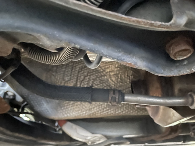

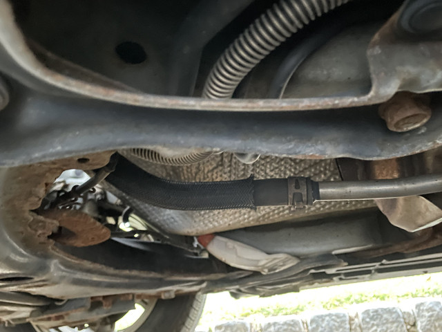

    HI I was about to start my car, all the sudden I heard very loud sound coming from under the car.
    After hearing that sound I understood that someone cut my Catalytic converter.
    I would like help to find part that I need to buy.. shop will charge 150 for welding the new part.
    Thanks in advanced.

    Looks like they left you the heat exchanger undamaged. That was nice anyway.
