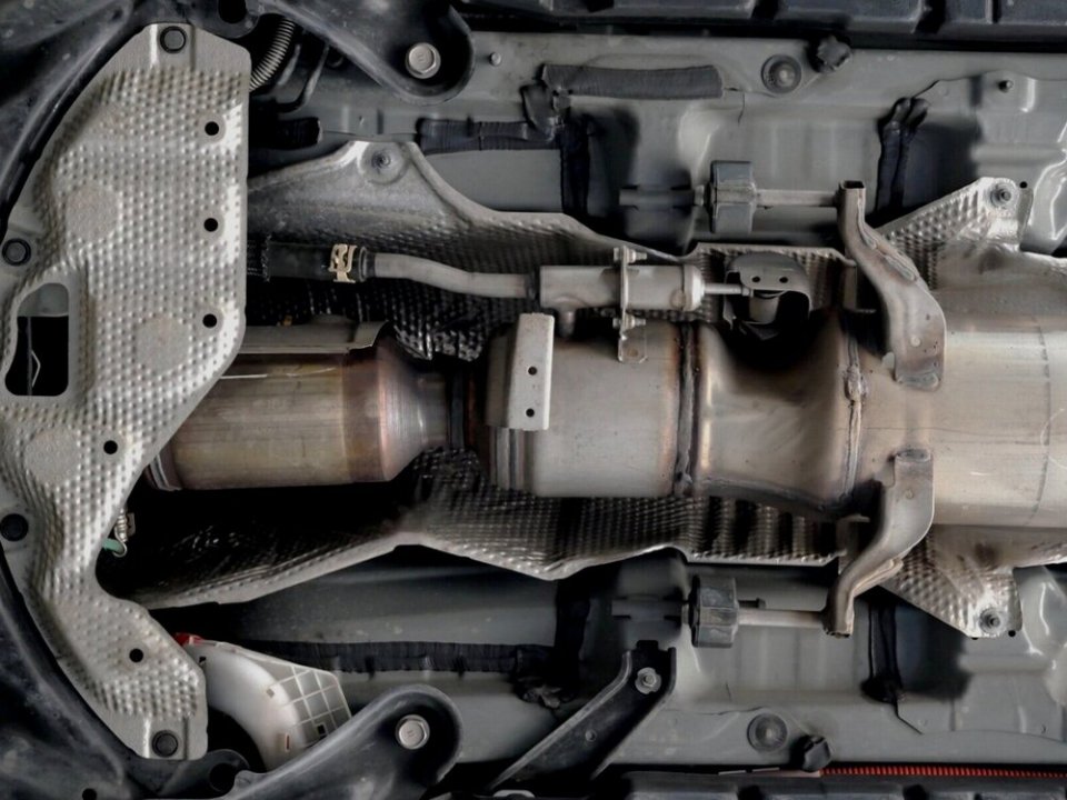

    The exhaust gas preheater does more that just preheat the engine. It heats the entire climate control system. It replaces the thermos found in the Gen 2 Prius. Eliminating it will mean that the system will continually throw an error code and hunt for it.
    Unfortunately, the OP had either a stupid of uncaring thief who either destroyed or took the exhaust heat exchanger, too. A careful or professional thief would have taken the cat only.
    Unfortunately, an OEM replacement is the only option in this case. 655A1FC5-BD89-4DDA-BB89-EC12986D2959.jpg
