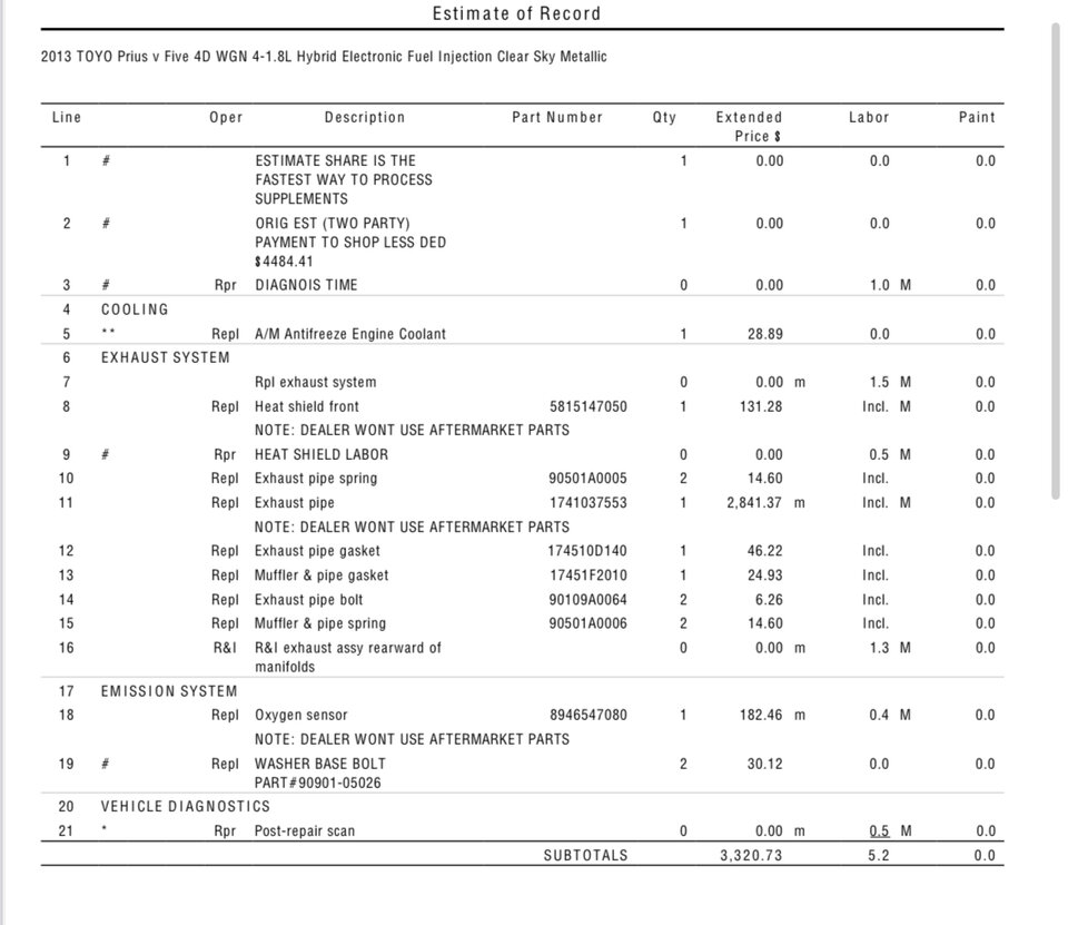

    Someone stole the catalytic converter off my daughter’s 2013 Prius V Five last week while she was parked in the city. We have comprehensive coverage on the car, but after getting a $4900 estimate for a new cat, o2 sensor, and heat shield they damaged I’m expecting this to be a fight with the insurance company.

    I think they won't total the car. They may refuse a dealer markup.

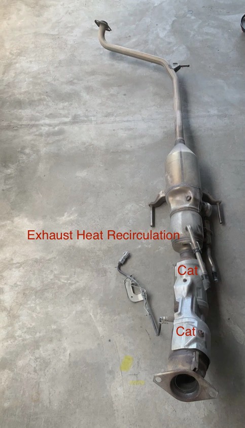

    Allstate is not great to start with but that dealer price is high since retail for a bolt on cat and exhaust heat recirc system is around $2k.
    I would expect a $2.5k to $3k offer could allow a muffler shop to install an oem cat and recirc system.

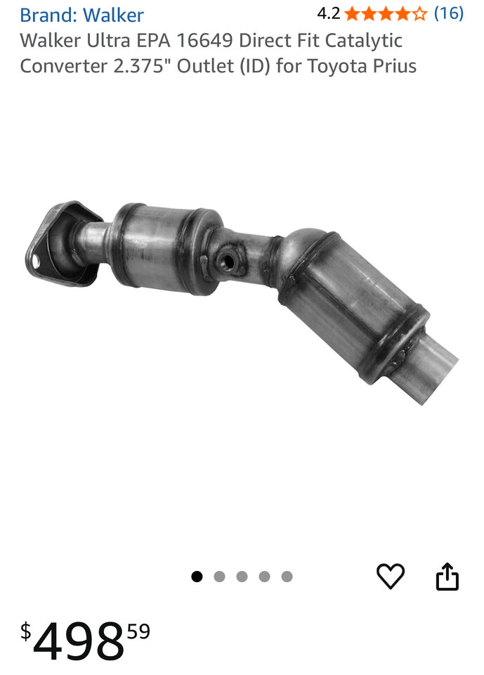

    There are aftermarket cat only suppliers like the Walker 16649 that will keep the light off. Assuming they left the recirc system. The concern might be for how long the Walker cat lasts especially if your v burns oil which is common. I have seen one Prius go three years and counting with a Walker.

    What aftermarket cats have folks had good luck with? I need more than the $500 walker cat provides. I’m also willing to fight with insurance to get one that will last for years… a 12 month solution is IMO a non-starter for a repair since everything was working fine before this and I’m reasonable confident the original would have still worked well for years.

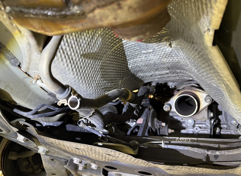

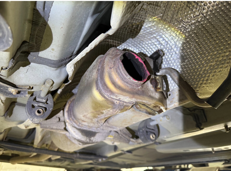

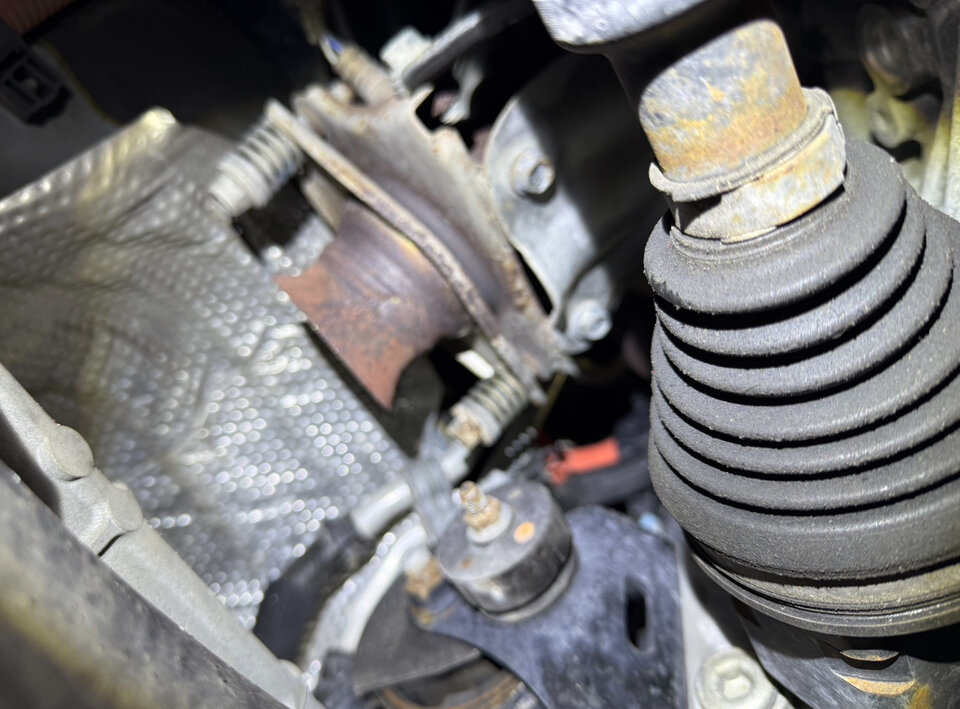

    Photos of the carnage…

    Buy the OEM part and have a muffler shop install it. It's a bolt-on with two doughnut gaskets, need to by another down-stream sensor and the EGHE hose connections. Easy-peasy. about 1.5 hrs labor.

    Obviously you want oem if you can get it for the money they give you. However insurance companies know you are not a carb state and normally only price out aftermarket parts. If you find yourself in that position a Walker will work IF your car is not burning oil. 99% of the others will not work. It looks like the recirc system is still there if needed.

    Well shockingly to me, Allstate took a look today and approved the $4700 dealer estimate. All I owe is the $250 deductible.
