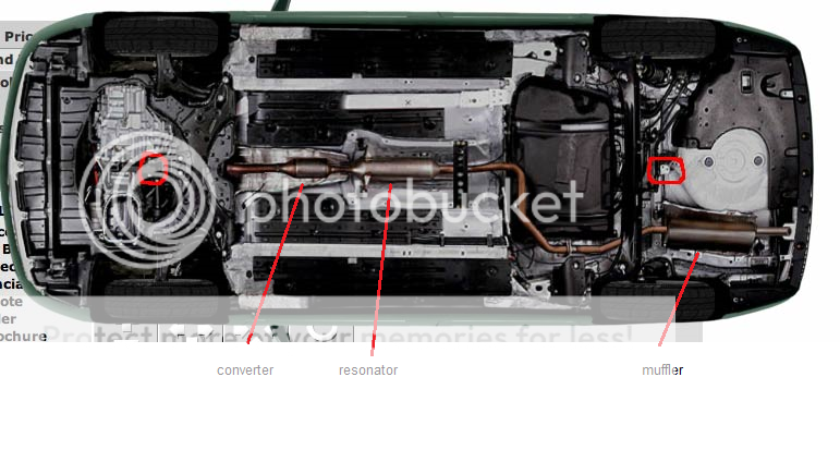

    I found the below picture online (not a pretty one) that shows the underside of a Prius which looks identical to my 06. Notice the long resonator then what appears to be a cat and then further up the primary cat. I'm really anxious to see what is inside that cat appearing piece directly in front of the long resonator. My Lexus has 4 cats. 2 primaries and 2 secondary (which are not monitored) and I suspect that is what it is.
    Patrick Wong likes this.

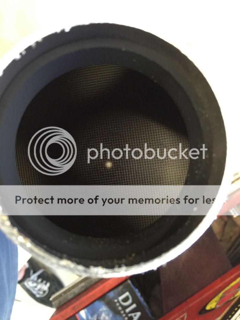

    Got my stock cat replaced this morning. I can confirm that the 2006 Prius does indeed have 2 cats. One primary that is monitored with O2 sensors and a secondary cat which is unmonitored. Anyway the factory cat was removed and looks good which tells me the metals used in the cat must have depleted or something causing the inefficiency codes that I kept getting. Drove 60 miles so far and no CEL.
    Photo looking inside of the old cat with 126,300 miles on it. Looks fine visually.
