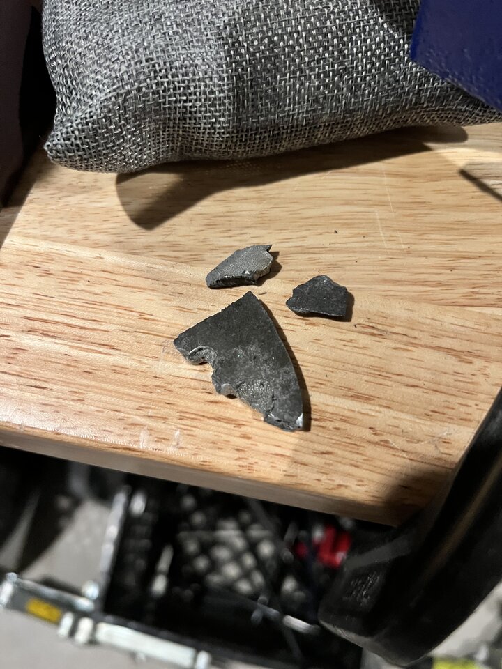

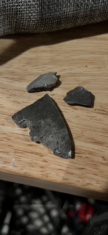

    First I’d like to thank anyone who reads this. Time is valuable and I appreciate it. 2013 Prius v. 195,000 miles. Just bought it. Got the title in the mail a few days ago. Wife was driving and sitting at a stop light. Started to go and there was a snapping sound and it wouldn’t go. She pulled over immediately, in seconds, and the lights on the dash came on. There is a big oil leak down the back side of the motor. It’s all draining down right where the oil filter and plug are. But it’s clearly coming from higher up. When I removed the panel these pieces of metal fell out. That doesn’t sound to me like a blown head gadget but what do I know. They seem like lightweight pot metal fragments. We had been having a noise when steering the car. Just a bump. She said the steering seemed fine as did the brakes. I can’t see anything obvious in the back of the motor. Any ideas what this could be?

    Sounds like a blown head gasket bent a rod which broke a hole in the block. It happens. If that is the issue you need an engine. I would put a Hybrid Pit Rebuilt Gold in or a JDM used in Japan engine.
    I would take it back to the seller. These things don't happen overnight. They progress over months.

    You might want to chase the seller. Gen 3 (and the v) are very prone to head gasket failure, which culminates with such events. For starters check the engine coolant for evidence of a stop-leak product.

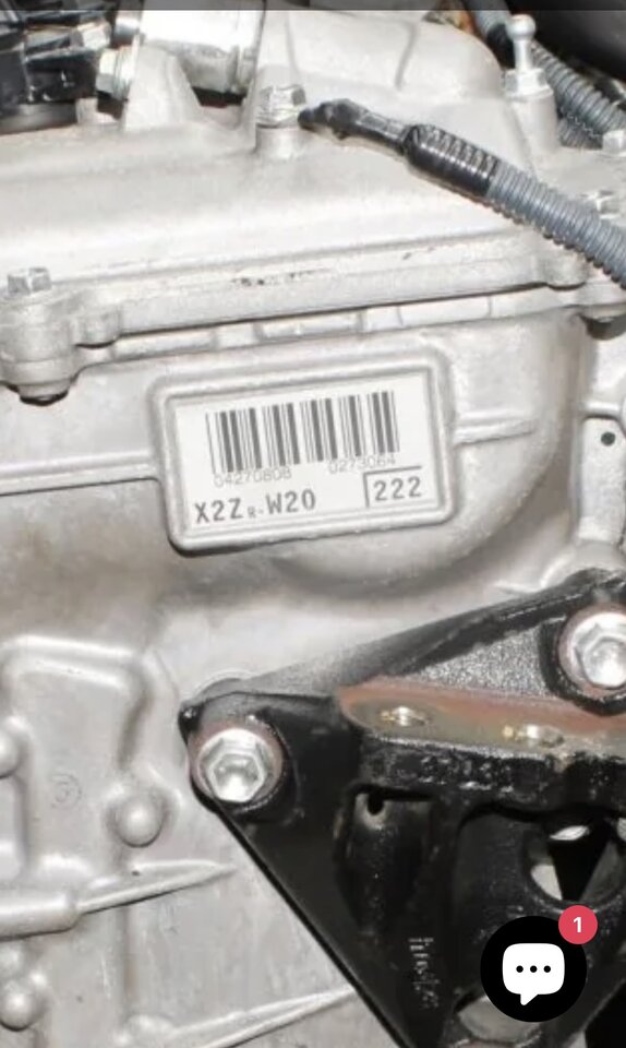

    If you are not getting a rebuild engine that includes updated pistons and rings (the early versions were poorly designed on a 2010-2014 Prius) OR it is determined the friend is just swapping in a salvage yard engine (the most common knee jerk reaction and very low cost) it is much better to compromise with a JDM used in Japan engine obtained from a JDM engine importer (distributors in many US cities).
    Such as this distributor in Dallas
    2010-2015 Toyota Prius Hybrid JDM Engine 2ZR-FXE 1.8L 4 Cylinders – Dallas JDM Motors
    A legit rebuild with revised piston and rings is obviously better.
    JDM Engine Model Number is
    X2ZR-W20 instead of X2ZR-W25

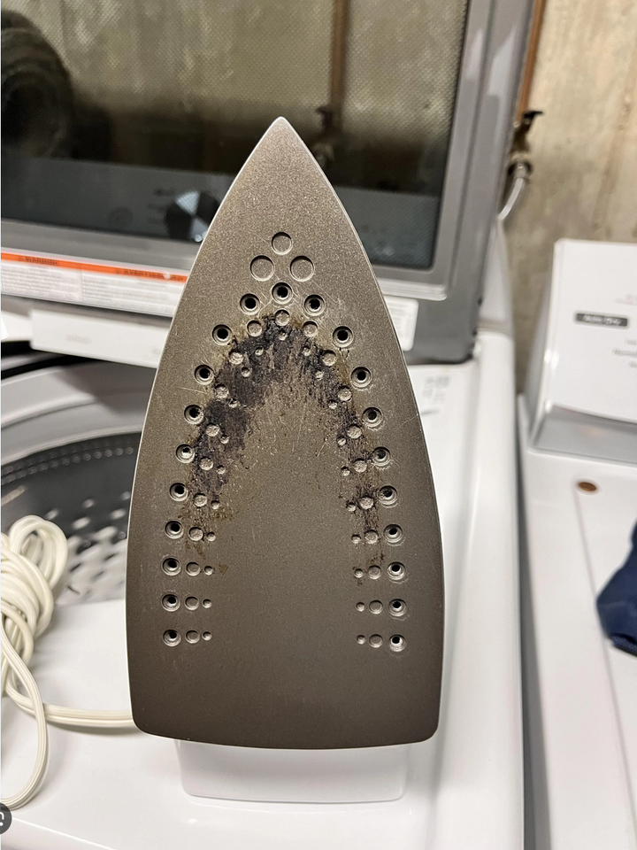

    Is it me or does that look like fragments of a iron press?
    I don't think engines just fragment like that when a head gasket blows. At worst I think major warping.

    See video in post 2 above. Normally the connecting rod bends slightly and then gives way violently with continued operation.
