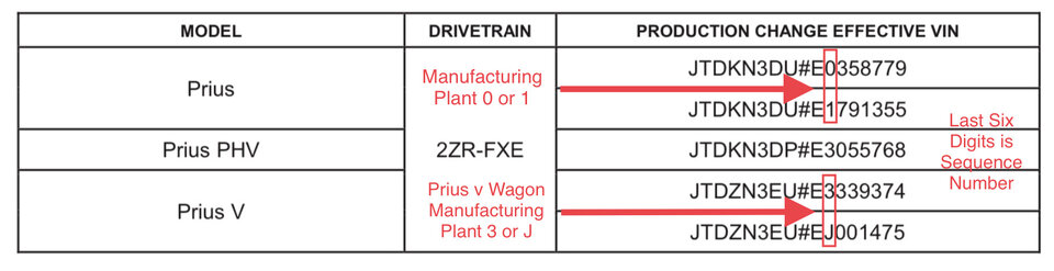

    Sounds like they are charging $200 a hour labor. The plugs alone at $499 is at least $400 in labor which could be done by an independent for one hour labor at a reduced hourly rate.
    The oil change and coolant changes are the two I would do at 5k and 50k mile intervals no exceptions. Consider driving an hour to find a reasonable Prius experienced shop using those two items as a barometer. If you like them get pricing for the rest and execute over six months.
    Also verify your vin to determine if your 2014 has the revised pistons and rings.
