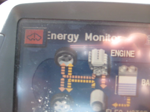

    Well, it's hot here in the desert and yesterday was the first time it happened again since last summer.
    I just turned the car on and off a few times and then it let me put it in drive. The red triangle stayed on but at least we could drive it.
    It's obvious that the ambient temp either in the car or outside the car is making this problem worse. Besides the battery, I'm not sure what other components could be affected by the heat.
    Anyone wana buy this Prius? I'm about to drive it off a cliff.

    I had the same error message. :mad: The dealer was of little help. But, I found in this forum many suggestions to change the 12 volt battery. I did just that and have not seen the frustrating error message again. :)

    Similar experience here. New 12V battery was the solution so far.
    For the last couple months or so, about every startup, the red triangle ! light would flash momentarily, then start fine. Twice, my wife was stranded for a few minutes with the same warning message that begins this thread about the park lock abnormal, etc., but was eventually able to get the car going. I had DTCs checked, but nothing was logged. The suggestions here pointed me to the 12V battery. I knew it was getting weak, but was surprised to find it at only 10+ volts after driving. Changed it and all seems to now be well.
    I'm surprised that this battery is depended on to shift out of park. If the car waited for a moment more for the hybrid system to fire up, wouldn't there be lots more juice to draw from for the task?
    Since such weird and seemingly unrelated problems can stem from a weak battery, it also seems like an oversight not to have warnings implemented for when it gets to be in bad shape. 10 volts is pretty bad shape.

    I ran my battery down the other day by running the interior vent fan without the car running, and it triggered this warning. So the most likely cause of this warning seems to be a low 12V battery.

    When you want to listen to the Prius stereo, you need to put the car in ACC-ON mode, where the MFD is on, but all instrument panel warning lights are off. This can be done by pressing the POWER button once, from IG-OFF. It sounds like you put the car in IG-ON mode by pressing the POWER button twice, which causes the various warning lights to be on. The drain on the 12V battery is very high, when in this mode. Do not allow the Prius to remain IG-ON for any length of time.
    Whether or not this happened before, you need a new 12V battery now. As stated above, you also need to ensure that the car is in ACC-ON mode when listening to the stereo (not IG-ON mode.)

    Yes, your 12V battery is near death.
    I'd go farther than Patrick and advise leaving the car ON ("Ready") and in Park whenever you use any accessories. It avoids the battery discharge problem altogether, at least until the car runs out of gas.

    Your 12V battery is near the end of its life. If it will inconvenience you unduly to be stuck in the middle of nowhere, then I recommend that you replace it now.
    I would not bother to have the battery tested, because battery testing as performed by the dealer is unreliable. Use the $98 towards the purchase of a new battery, which has an MSRP of $139 (although some dealers are not afraid to charge more.)
