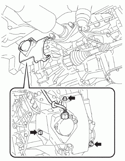

    Does the car go into Park when you hit the button at a stop? Meaning, does the parking pawl actually engage so that the car does not roll? Does it come out of park without problem if parked on a hill (and thus causing more friction on the pawl)?
    If the 12V is not looking suspect, the first thing I would be inclined to check would be the harness and plug where it attaches to the Shift Control Actuator. Make sure the connector is clean and seated properly. It is not easy to get at, unfortunately. Car needs to be on stands to get under. It is right next to where the exhaust pipe exits the ICE. Given winter conditions, with lots of sloshing in salted puddles perhaps, it might get fouled. If the answers to the above are Yes, then I agree that it might be a problem with the sensing leads going from the Shift Control Actuator to the Transmission Control ECU.

    Sorry it took so long to get back to you.
    I did finally look at it and the harness is tight and everything looks ok. Nothing obvious anyway but I wasn't able to remove the plug for further inspection.
    To answer your questions:
    The car does park. I don't have too many hills to test this but on the small hill I did test it, it seems to come out fine. I parked it and even manually tried to push it. It rocked but it did not roll.
    Question:
    The Parking Pawl is a 3 phase AC motor. Does it do any sort of charging up prior to the car stopping? Sort of a "preparing to park" type thing?
