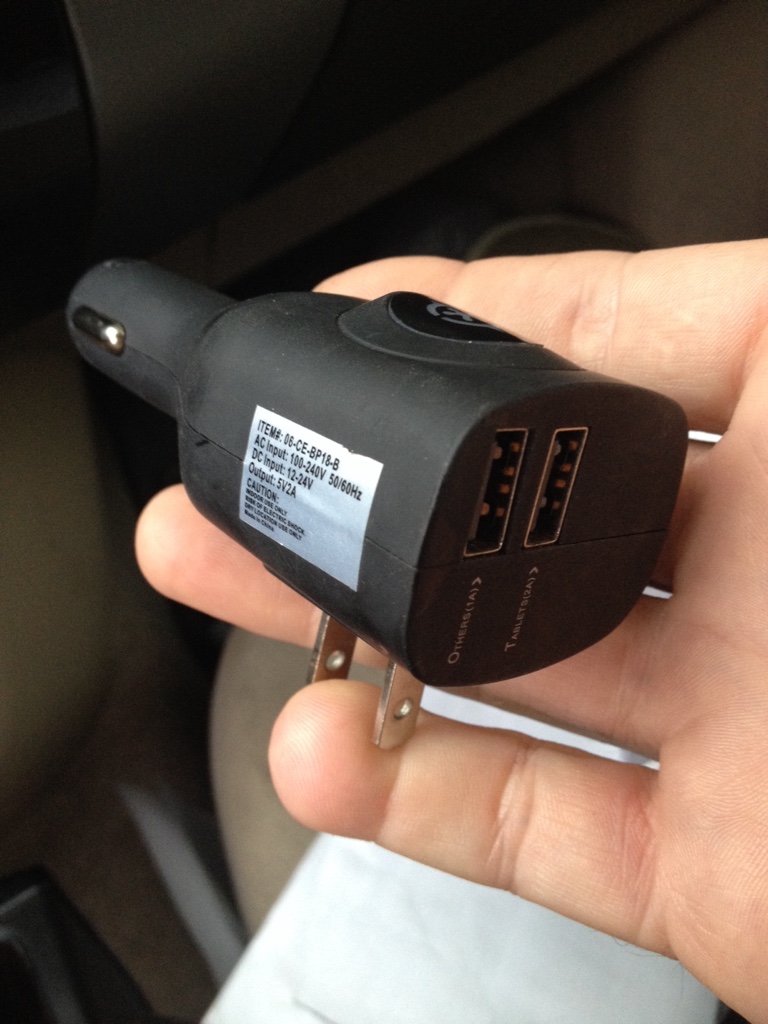

    The 12volts available at both plugs is plenty to provide the 5 volts the phone needs.
    I had trouble with the Chargers Sprint provided for $50 and found the $20 USB chargers from PepBoys worked so well I bought them for everyone in the office for Christmas 5 volts 1 amp
    Here is a picture[​IMG]
    As you can see it is a dual charger gives Tablet and a phone a charge in car or hotel Etc. I have a spare in armrest counsel.
    I've repaired power supply's too if you have one rated to provide the 5 volts but not the 1 amp that one draws while navigating ect many over heat and just cannot keep up. FYI
    iPhone ?
