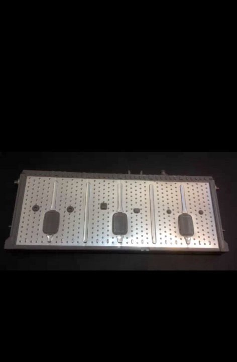

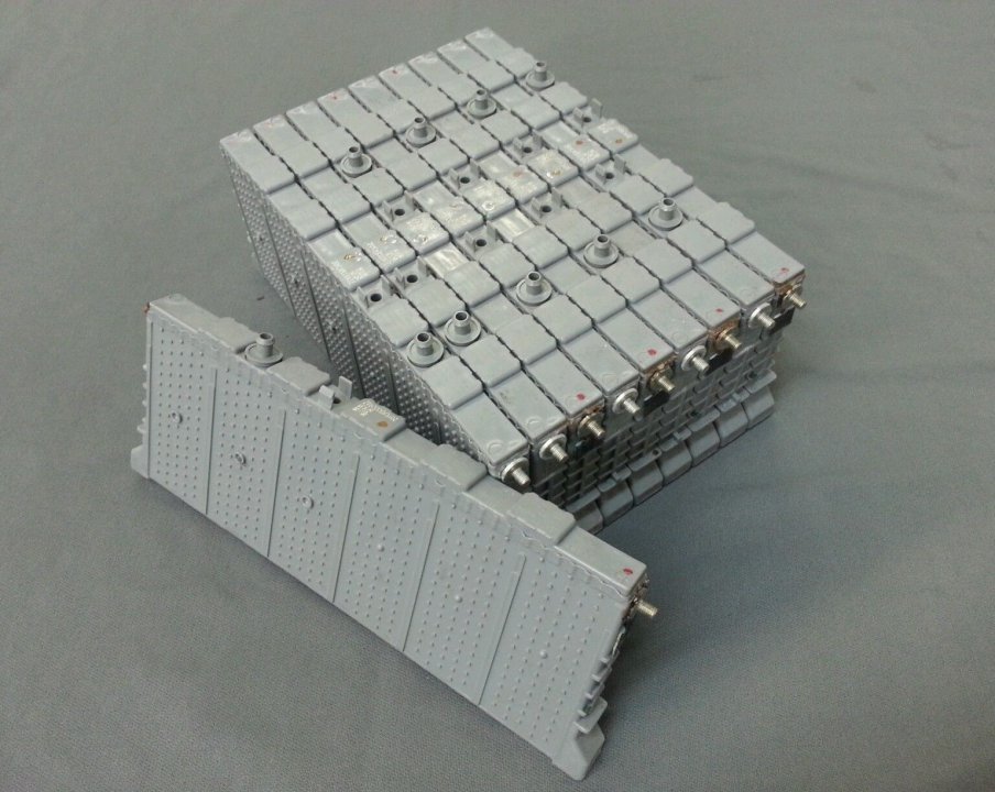

    Here are some photos of the Gen 1 and Gen 2 modules. The Gen 1 looks like plastic, with the Gen 2 clearly metal.
      File size:
      107.7 KB
      Views:
      398
      File size:
      23.4 KB
      Views:
      456
    hybridbatt likes this.

    Both modules are plastic but the gen2 module have a thin metal plate on each side to improve conduction for cooling.
    John (Britprius)

    The metal on the sides is more like foil molded into the plastic. It is extremely thin. I'm pretty sure all it does is spread the heat around evenly to provide better cooling.
    Avi
