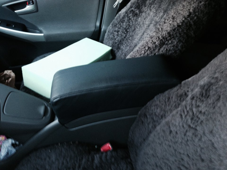

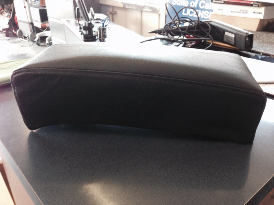

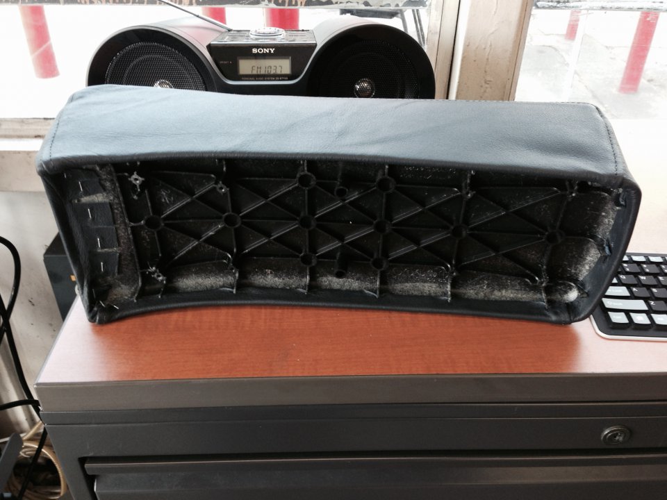

  15. Joele3
    Joele3 Active Member
    Jan 1, 2010
    136
    205
    Bay Area
    Thanks to this thread. Here is my center console mod. I used 3.5 inch foam wrapped with leather over the original console. I was testing out the other piece of foam on the console from Joann's which was 6 inches way too soft and tall. I ended up going to Bob's Foam Factory in Fremont, CA he let me try out different foam pieces.
