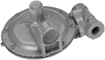

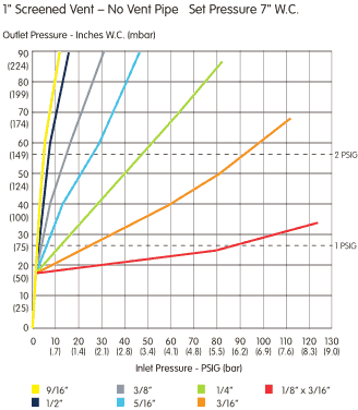

    Six psi arriving at my house would be controlled perfectly well by this guy outside at my meter:
    And an overpressure from outside would have to be yuuuuge to exceed that guy's venting capacity by enough to reach six psi in the house. They stopped the graph before 3 psi, and for the red trace (that'd be my house, with the smallest available orifice) to get anywhere near six psi out, it would have to be hundreds of psi in.
