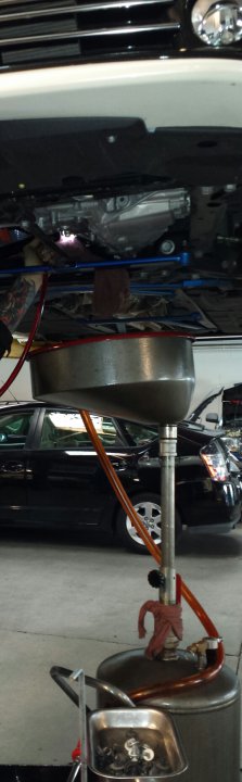

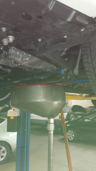

    Mission Complete. I am good for another year.

    So I spoke to the mechanics at Luscious Garage, a very reputable shop in San Francisco who have actually dealt with alot of high mileage prius beacuse they handle alot of the prius cabs in the bay area upwards of 200,000 miles on these cabs and they recommend inverter/coolant service at 100,000 mile intervals. I trust them that's why I went there for my ATF. Saving my $$ for more mods. Haha

    Yup. But Luscious Garage does recommend 30,000 mile intervals on the ATF.
