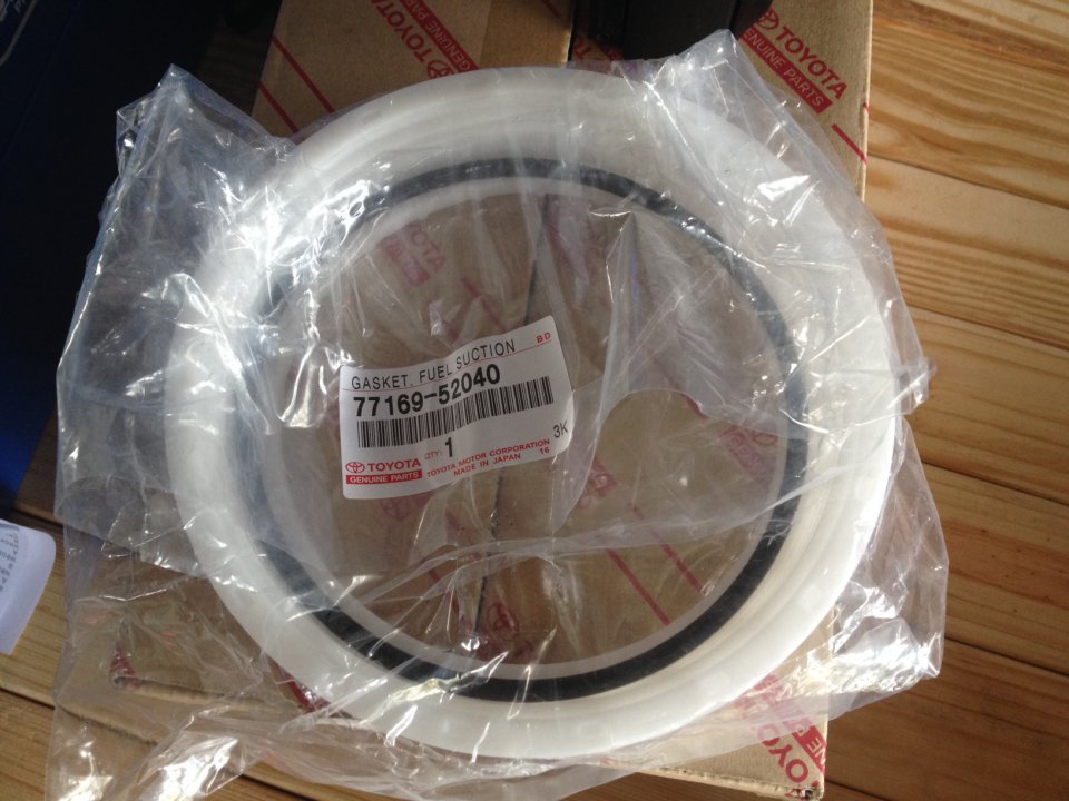

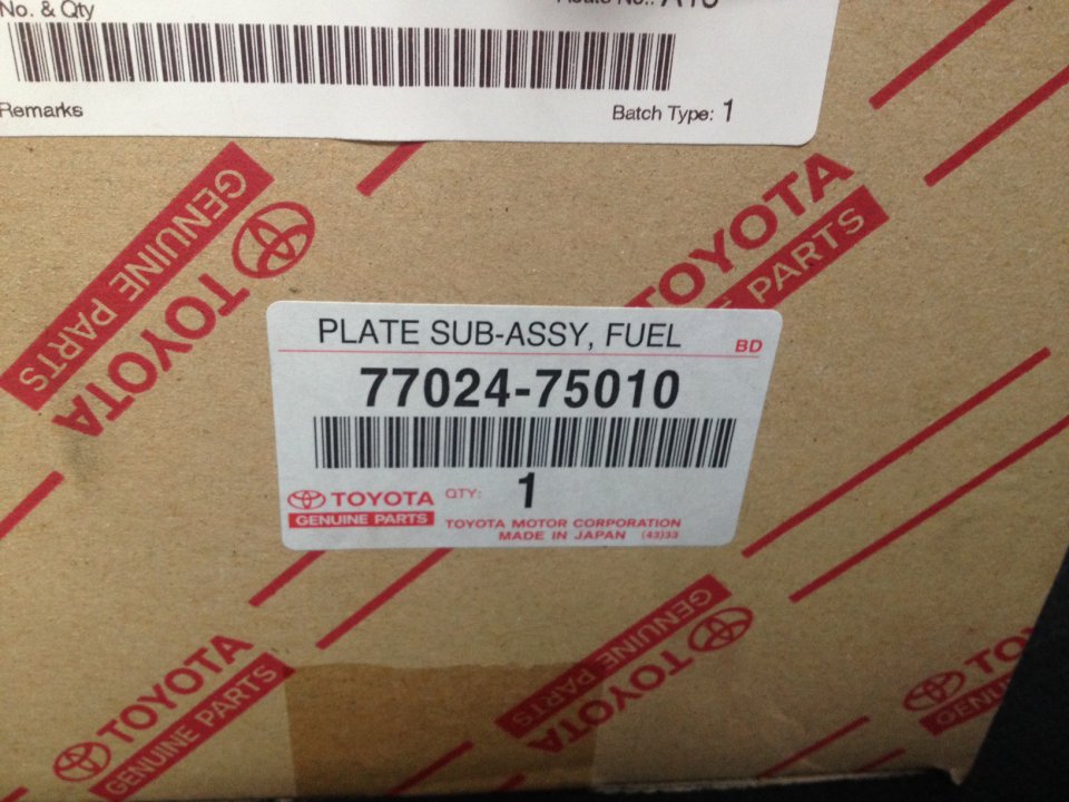

    Parts required are as follows. These were all in stock items at my local dealer as they sell them often for this service:
    New top plate and Large O-Ring

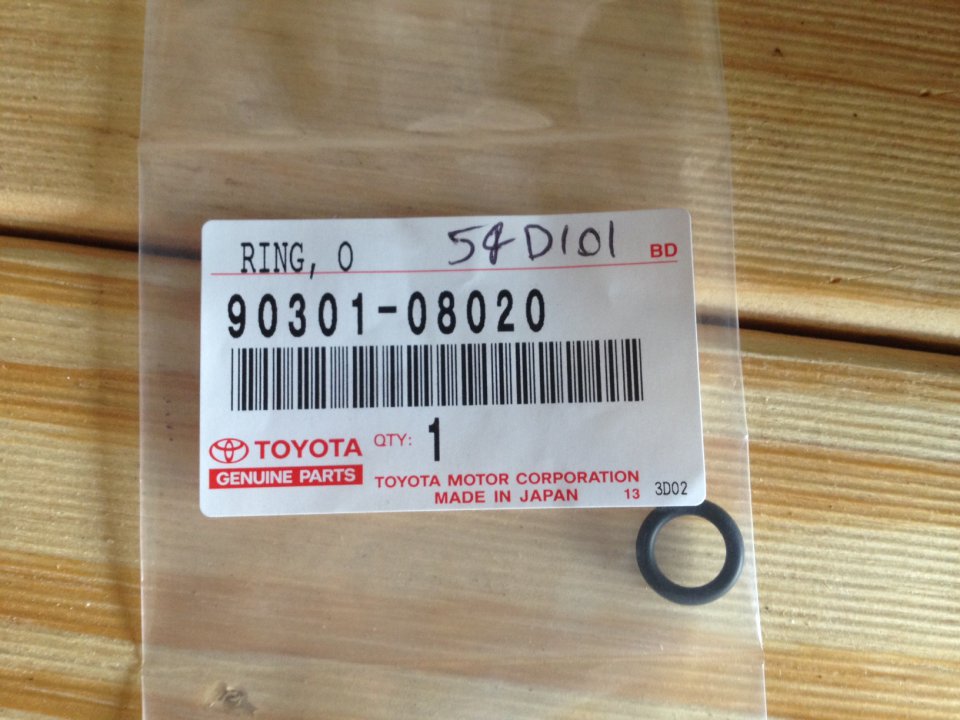

    Small O-Ring for inside the filter on the fuel pump.

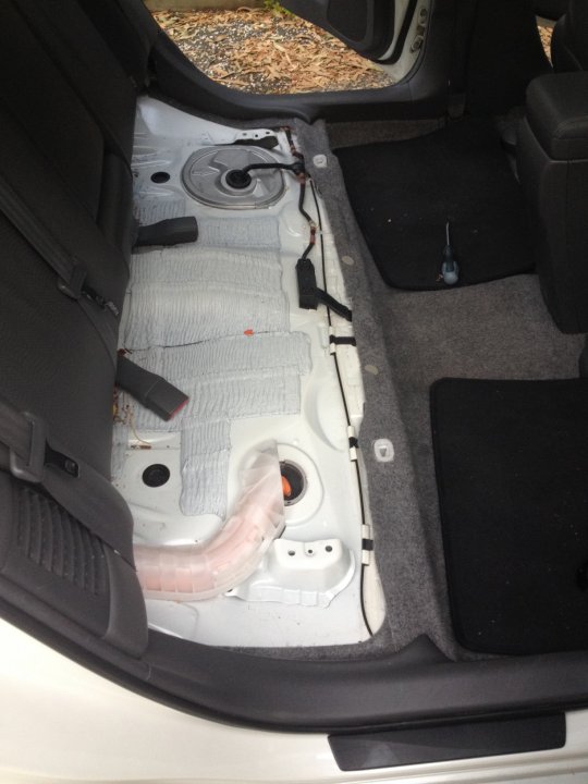

    Firstly start with a near empty tank as it will be less messy.
    Remove the back seat base. Pretty simple, just put your front seats fully forward and crawl in to the rear foot well. Apply pressure in the middle of the left hand seating position with your knee and pull the seat up. Repeat this process on the right side. You will see in the picture below the 2 white catches at the edge of the carpet that the seat clips in to as a guide as to where to apply the pressure and pull.

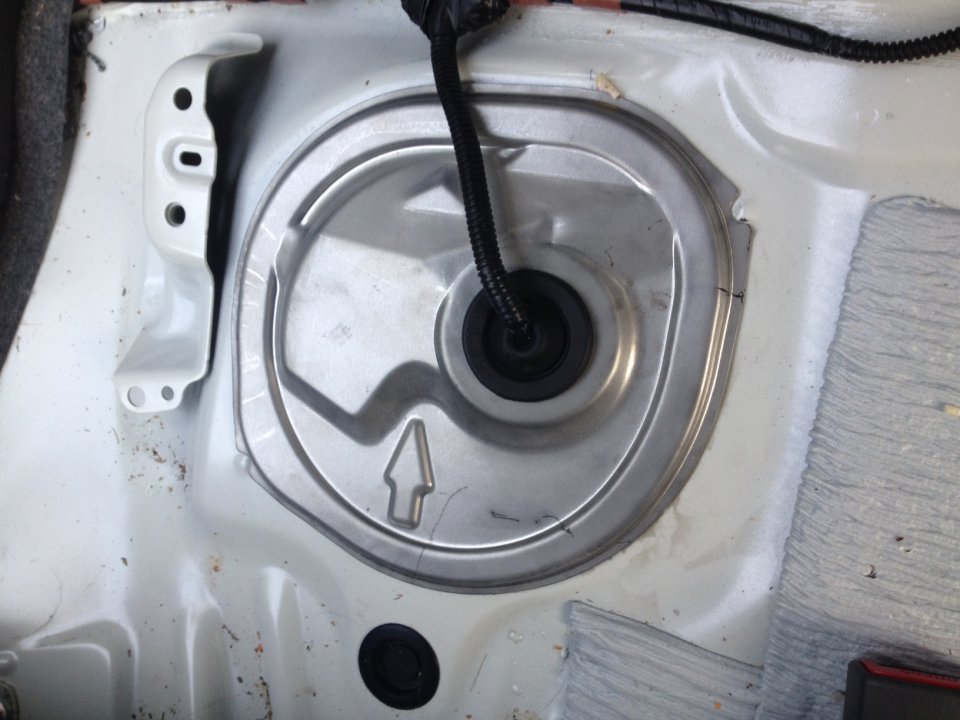

    Look under the seat for a silver plate.
    It has no screws and is just stuck on with a sticky black glue. It lifts quite easily with a large screwdriver.

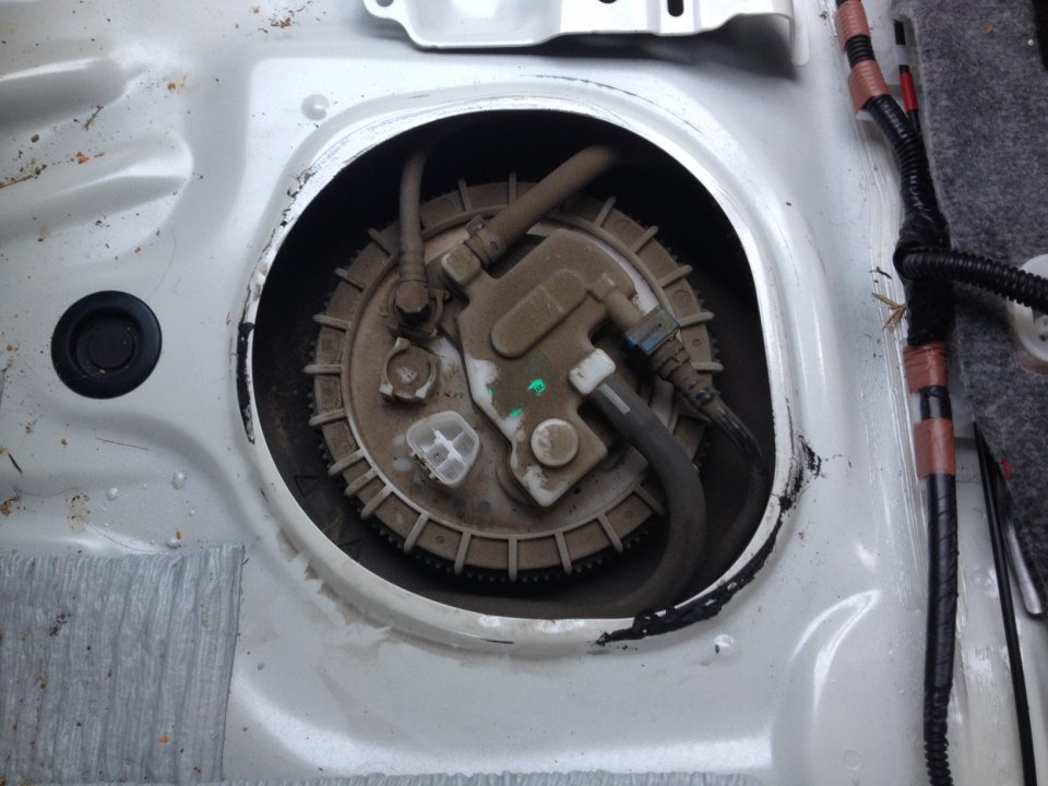

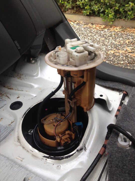

    Once removed you will see the top of the fuel tank and the fuel filter lid.
    Remove hoses and clips. Look carefully at how they clip in as 2 of them have small clips that need to be unclipped before pulling on the hoses. It is pretty logical if you take the time to look at the clips before pulling on them.
    Next is the hard bit. The lid is on TIGHT. I think this is why you have to buy a new lid with the O-Ring as you will need a rubber mallet and large screwdriver to unscrew it. It takes a bit of persuasion to unscrew by placing the screwdriver on one of the notches and hitting it with the rubber mallet.
    Once unscrewed the filter will pop up as it is spring loaded. You need to gently remove the entire assembly from the tank by pulling up the first section and the maneuvering the bottom half through as shown below. Be gentle here as it only just fits when on the right angle. Once the bottom section is through you then need to feed though the float, all attached in one piece.

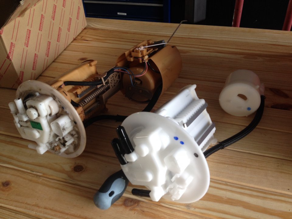

    With the whole assembly removed you need to take it to a clean workbench to install the filter as you only get part of the assembly to replace as shown below :
    This may look hard but really it is quite simple. A bit of common sense and unclip all parts from the old and attach them to the new. Apart from the big white filter assembly, there is ONE REPLACEABLE PART in this process and that is the small O-Ring which slips over the end of the fuel pump located in the bottom round canister part (I forgot to take a photo of this part). The slide part needs a gentle squeeze and pul to remove from the track and the new one just pushes back on. Everything else seems to unclip and clip back in quite easily, you may need a small screwdriver to release a few clips as you go but there are no screws at all in the process.

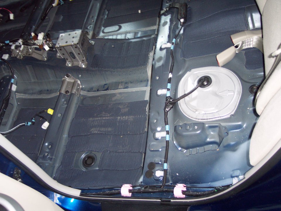

    GAM, thanks for the excellent write-up with pictures. Yes, the US version is the same. Here's a shot of mine when I took the back seat out for Dynamat:

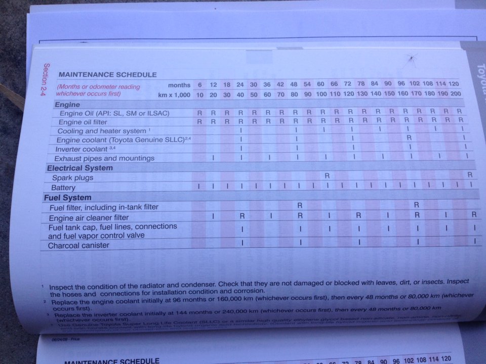

    That's interesting as in Australia it is listed at every 4 years/80,000Km.
    I've never known a car that doesn't need a fuel filter change at some stage as Prius's don't have magic fuel, it all comes from the same pumps.
    Some people have already posted fuel issues on this site and have had to have filters replaced as a result.
    Do you have better quality fuel in USA and don't change the filters for any other cars either? Or is your cartridge some kind of different type internally? If anyone does the change, pull the filter apart and see what is inside. I have a video of mine which I have not yet downloaded from my camera, but is appears to be charcoal granules.
