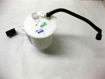

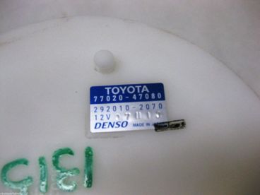

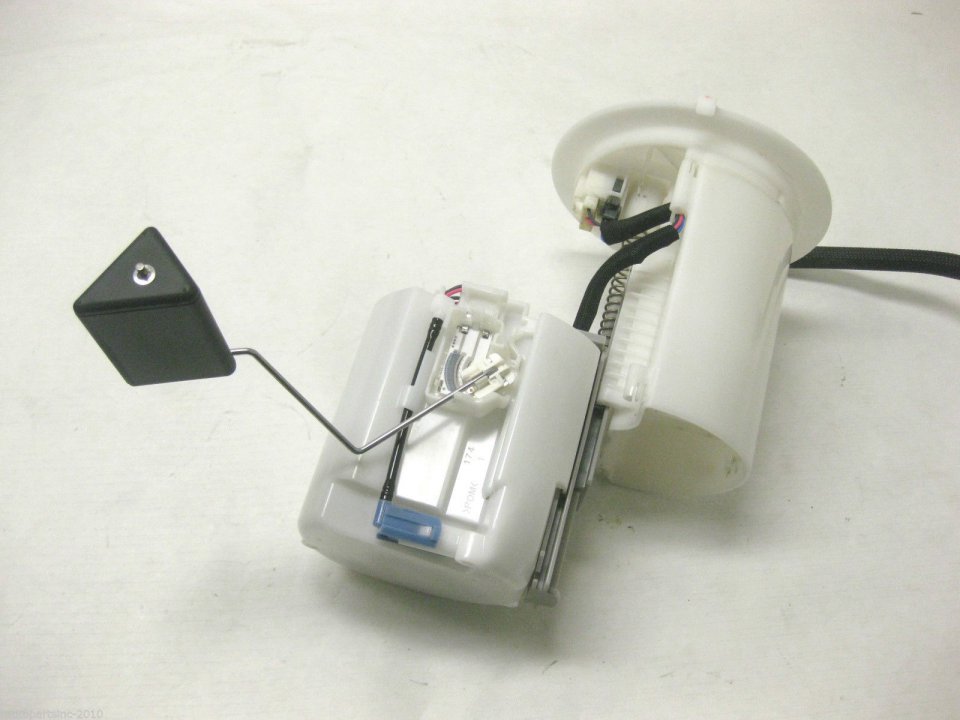

    The US fuel pump assembly appears to be different. I've posted photos.
    Old Wrench It and Patrick Wong like this.

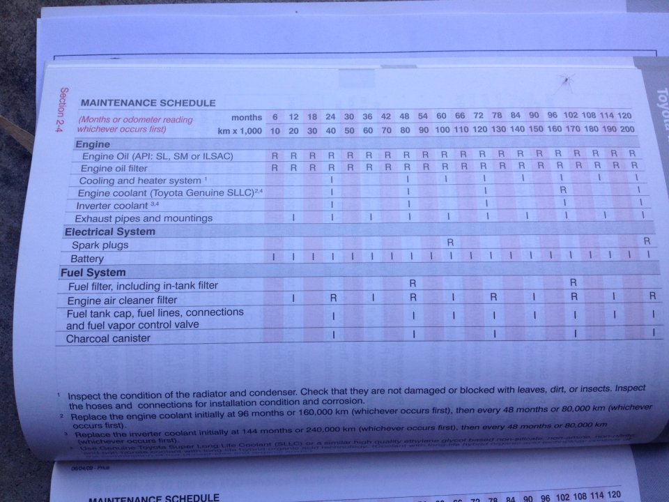

    Here's a condensed version of the Australian Service Schedule:
  12. Mendel Leisk
    61,533
    42,345
    There's an instruction in the above, to change the transaxle fluid, in the severe service: at 4 years or 80,000 kms, whichever comes first.

    A few variations I noticed in the Australian Owner 's Manual:
    1. It calls for cross rotation of the wheels, ie: straight back, then cross to front. (North American manual stipulate same side rotation only.)
    2. There's no mention of TPMS.
    3. Spec's same spark plug as North American manual, but change interval (in maintenance booklet) is 5 years or 100,000 kms, vs 10 years or 144,000 miles (US) or 192,000 kms or 12 years (CAN). (The date component is a moving target in the North American manuals, but roughly right.)
  14. Britprius
    Britprius Senior Member
    Jun 14, 2010
    5,194
    1,922
    Herefordshire England
    It is noticeable that the engine and inverter coolant are not changed together in the Australian version.
    Engine at 8years 160,000km
    Inverter at 12 years 240,000km
    John
  15. Mendel Leisk
    61,533
    42,345
    Yes. I'll try to sum them up here:
    The US schedule has staggered intervals:
    Engine: 100,000 miles or 10 years (roughly 160,000 km's)
    Inverter: 150,000 miles or 15 years (roughly 240,000 km's)
    Subsequently 50,000 miles or 5 years, for both (roughly 80,000 km's)
    (per footnote 4 on page 51 of US Warranty and Maintenance Guide)
    Canadian schedule change both at same interval:
    160,000 km's or 10 years
    Subsequently 80,000 km's or 5 years
    (per graph style schedule, page 25 of 2014 Canadian Warranty and Maintenance Guide)
    The Australian schedule has staggered intervals:
    Engine: 160,000 km's or 8 years
    Inverter: 240,000 km's or 12 years
    Subsequently 80,000 km's or 4 years
    (per section 2-4 Australian Warranty and Service booklet)
