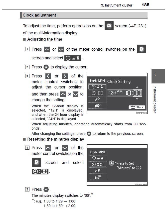

  12. Mendel Leisk
    61,428
    42,271
    This:
    Versus:
    I appreciate it's irrelevant, but...
    eluo and Tideland Prius like this.

    Well, I finally decided to change the clocks on our vehicles today. I had printed out Mendel Leisk's response with the page from the Prius manual that he posted last November. Took me about five minutes to change the clock on the Prius. Then changed the clocks on the 2002 4Runner and 2000 Lexus. Took about 30 seconds for each. Then the clock on my garage door opener: maybe 30 seconds. My computer and my digital weather station automatically changed to Daylight Savings time. I think Toyota's software engineers could have done better.
