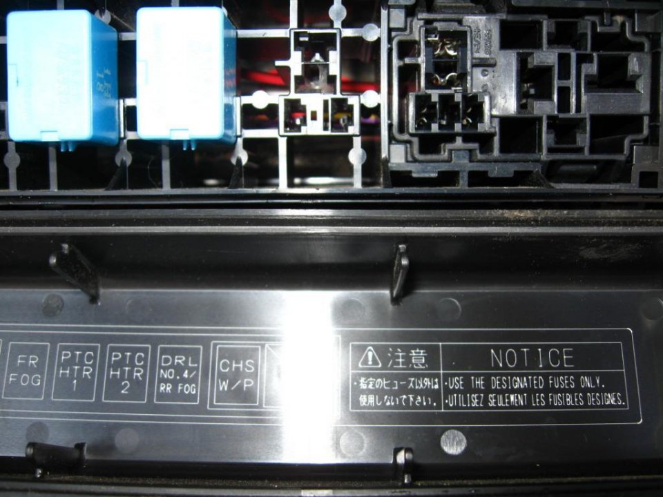

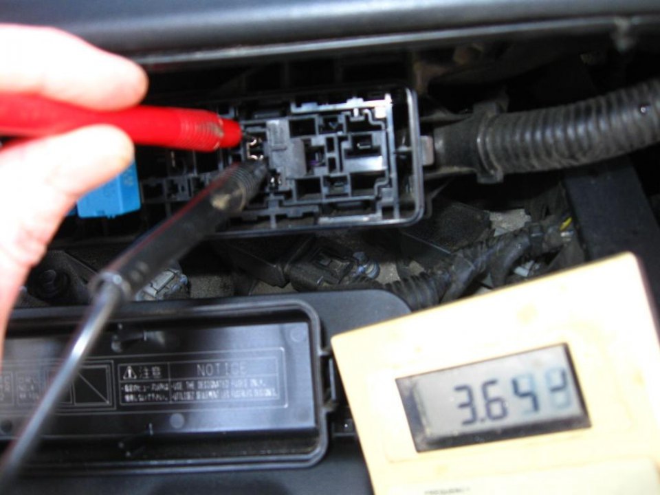

    I suggest the need to remove the coolant heat recovery system relay. The point of removing the relay is to manually bridge the relay socket with a jumper, in order to activate the CHS pump, as part of the process of getting air out of the engine coolant loop.

    Here are a couple of pix I found posted by another DIYer that show the relay & jumping across it. I just used a piece of coated wire with the ends exposed.
