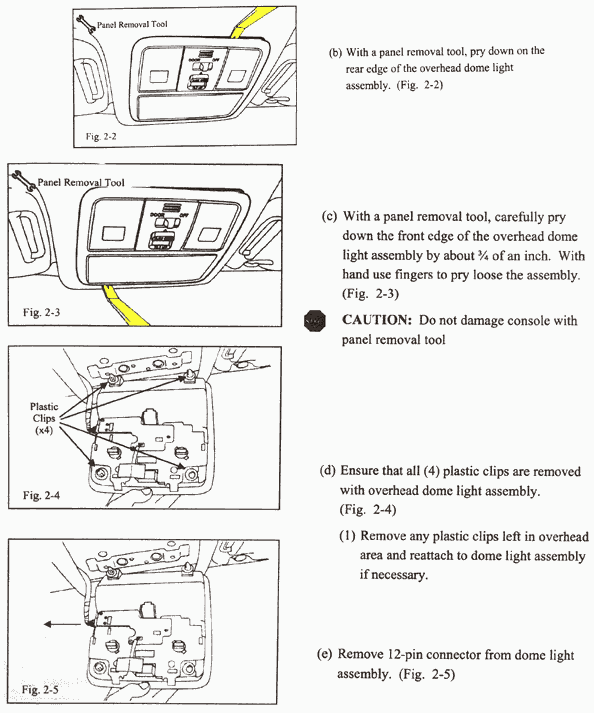

    I have seen video or pdf link somewhere but I did not save it.
    Here is something I found but I'm not sure it is the correct one:

    I've done it, here are the details with pictures how to do it.
    1.) Picture of the front dome assembly and point to pry down (only one). Once one edge goes down just pull it down with a bit of force, the other edge will come down.
    The PDF file I posted above looks like the same assembly but it INCORRECTLY states to pry down both sides down. You pry down only one edge and one side.
