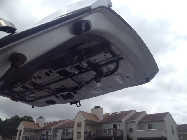

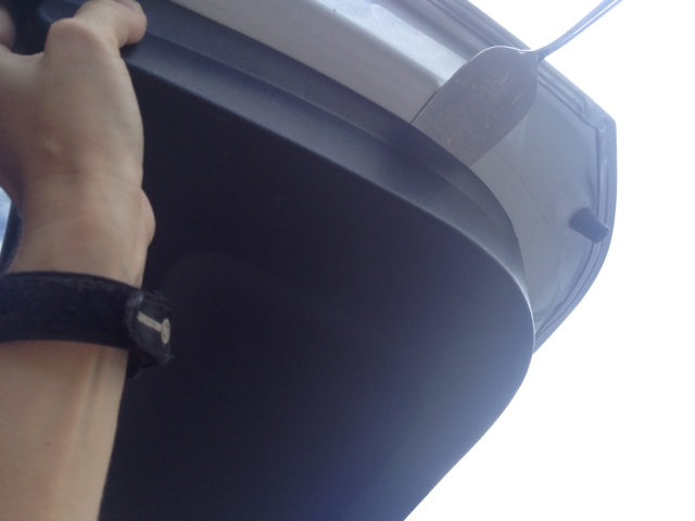

  13. savvydancer
    savvydancer Junior Member
    Jun 1, 2012
    I used a sort of cake serving implement to help me pry off the lower corner. The upper corner where it joins the back window I was able to pull it down a bit by hand, but couldn't get anything to pop (and was afraid of breaking the clips) so I used the little bit of a gap to slide the implement along towards the bottom, towards the "latch", and then got that one to pop and repeated it on the other side (so the lower left and right corners), and then it gave me enough of a gap along the whole bottom edge to just pull down and the clips popped off. None broke. I wasn't strong enough to twist the bulbs out so I gently used pliers, no real pinching pressure just enough to twist counter clockwise. It only twisted about 1/8 of a turn to come free. After that it was easy, replaced bulb, twisted back in myself without pliers until it clicked, and then popped the assembly back on. Implement1.JPG Implement2.JPG LicenseLights.JPG
