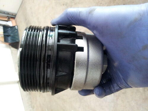

    Oil filter was so tight, I broke my oil filter release tool. Luckily the thread broke on the tool and not the oil filter cap. Stupid Toyota dealers. It's supposed to be hand tight. I couldn't change the filter so I'm not sure what I am going to do now. I'll need to buy a new more robust tool. Last time I had this issue, I put a screwdriver through the filter. Can't do it on this car as the oil filter is now just the paper element. Need to buy a new tool.
    I forgot to put that stupid metal clip back at the oil filter. I'm not opening up that stupid plastic flap again. There's no way the filter will release on its own so I'll just put it back in next time.

    Expensive, but this is the ONE that I use.
    Toyota - OIL FILTER WRENCH Part Number: 09228-06500-02
    It is designed to release the clips, and it is the one that I see the mechanics have and use in my dealer's Service Department.
    It is worth the price, if you change your own oil and do it often.
    If you read my earlier post, that's also the reason why I use OER filters and have an addition OEM cartridge housing on hand. Break it, and you're screwed until you can get another.
    While others said that have has success with aftermarket housings, I'd pay a little extra and get the OER one, on account of the valve that I mentioned.
    You're welcome Bisco.
    Yes, the valve is absolutely necessary.
    As insurance I use a small amount of LiquiMoly that is retained on the parts and clings to the internal engine parts.

    Any decent oil filter socket with 64 mm inside face-to-face and 14 faces will do. There's no need for it to extend further, into the intermittent stiffeners on the Prius oil filter housing. And the clip is a joke: it should in no way hang you up, it stops nothing.
    If you want to keep the engine underpanel in one piece, I'd suggest to take the whole thing off, not just open the flap.
