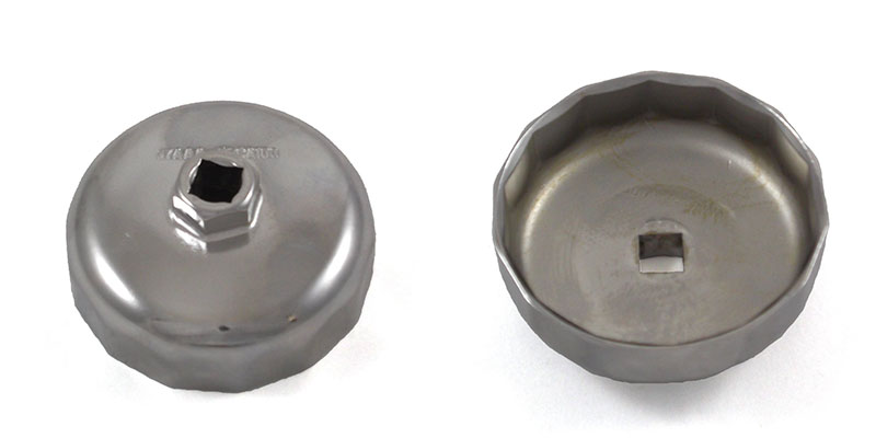

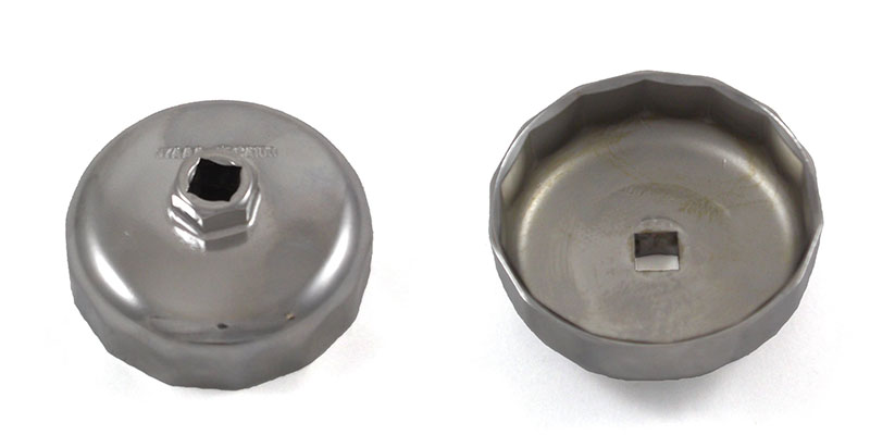

    18 ft/lbs is not trivial, it being a large diameter item, and does take a bit of effort to break loose next time. I'm the only one whose touched ours, always used a torque wrench. It is definitely more than "hand tight".
    The main object is to prevent it coming loose; the seal is the O-ring along the body. I mean, you could back it out a turn or two, it would still seal, as long as it doesn't start unscrewing itself, and even that's unlikely. The metal clip is ineffectual, at least it doesn't get in your way. Any regular oil filter socket of the right dimensions will work, there's nothing unique needed.
    I'm using a Honda socket, looks like this. Again, the spec is 64 mm inside face-to-face, 14 facets:

  16. mmmodem
    mmmodem Senior Taste Tester
    Nov 17, 2011
    2,732
    1,703
    Bay Area, CA
    That's the tool that broke on me. Mine was less robust. The square insert was a separate disk attached to the cup instead of one monolithic piece in the picture. 18 ft/lbs huh? I was always told hand tight. But this is the first paper element filter I've ever failed to change. We'll see if I have the muscle.
