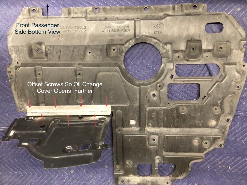

    The undercover helps cooling.
    The piano hinge modification
    douglasjre likes this.

    I had a better idea.
    Cut off the flap through the "hinge," then reattach it with six screws and two sheet-metal straps. To change the filter, remove two of the screws and the push-pins to take it off, completely out of the way, so the car doesn't have to be jacked up needlessly high for the flap to clear the ground.
