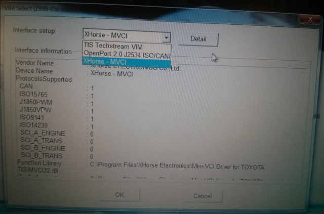

    Is there a label on it anywhere, maybe saying something like Mini VCI? Mine is kind of a silvery clear thing.
    If it is missing a label, you can go into Techstream's "VIM Select" menu and see what driver is selected. Maybe it looks something like this?
    The Mini VCI dongle I have is the one that has given me fits with the brake bleeds. I simply bought an Openport and installed its driver on the system, and then the already installed Techstream software showed it as another option on the VIM Select menu, and when I chose that and used it for the brake bleed, it worked fine. Didn't seem to be any issue with the Techstream software itself.

    yes pretty sure 'mini-VCI' was the dongle ...
