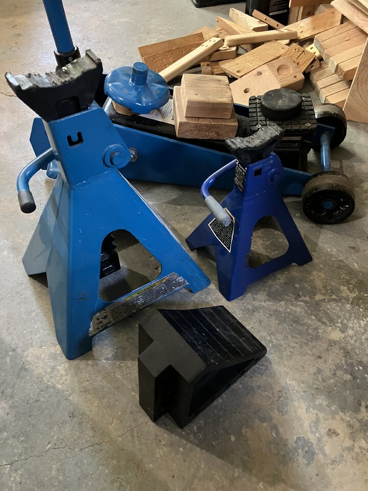

    I recently did a D+F on my 2012. New car to me so I took my sweet time. Did an oil change too. Removed the entire engine undercover to get a good look at everything, etc. And part of that plan was to do all that while parked heading in (4 degrees uphill) on my driveway, then jacked up (maybe +8* total), easy access to all my tools, shade, etc. is why I did it that way. That may have helped the oil and ATF drain.
    Then I filled ATF, used a funnel from above, with no spillage (1/2" ID = 5/8" OD soft vinyl hose is a perfect fit inside the fill hole) got 3 full quarts in before any fluid remained in the hose. So I of course stopped at that point.
    Then I turned the car around so it was facing downhill in my driveway, jacked it up until level (confirmed with a 4' carpenter's level) and put in about 0.6-0.7 more quarts at that point.
    So the amount of ATF you can get in there is definitely affected by the level of the car. The specification for filling is that the level be 0-10 mm below the bottom edge of the fill opening. Figuring it is more likely that eventually some may come out vs. get in there, I filled right to the max there. The spec capacity is 3.5 quarts (and of course that does not include spillage).
    Some pics from my gravity fill funnel method. The long screwdriver was stuck inside the hose so that I could easily poke it down through the gap from above to below. One man job this way.
