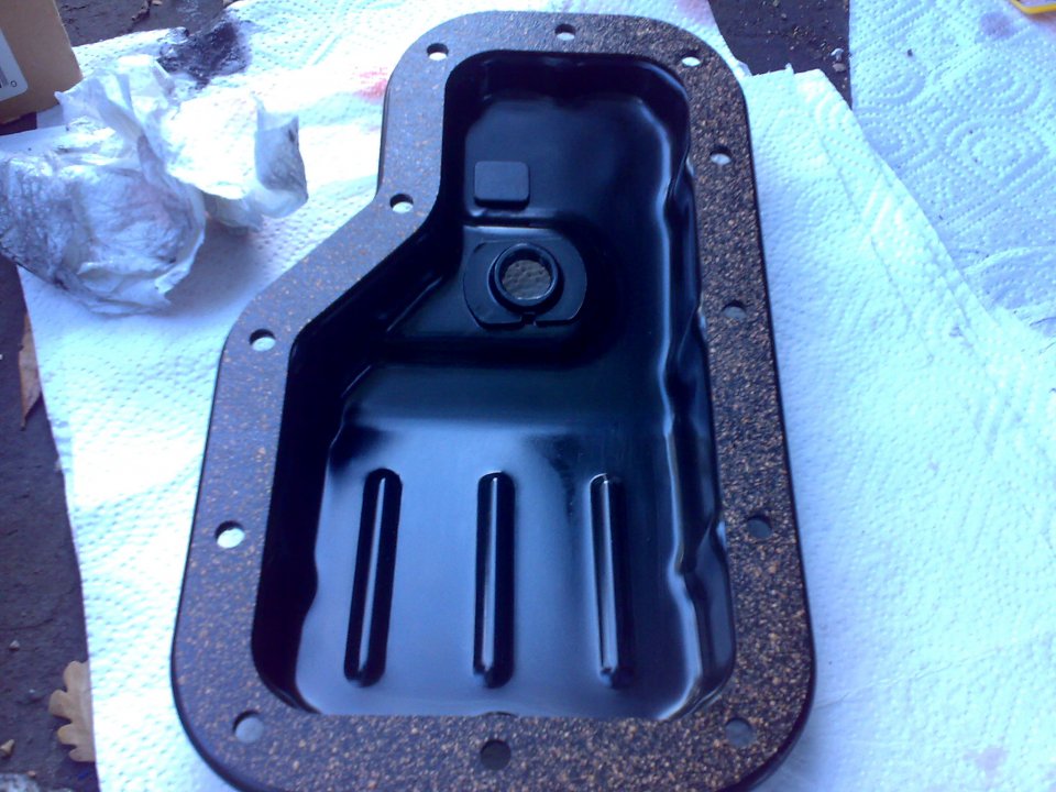

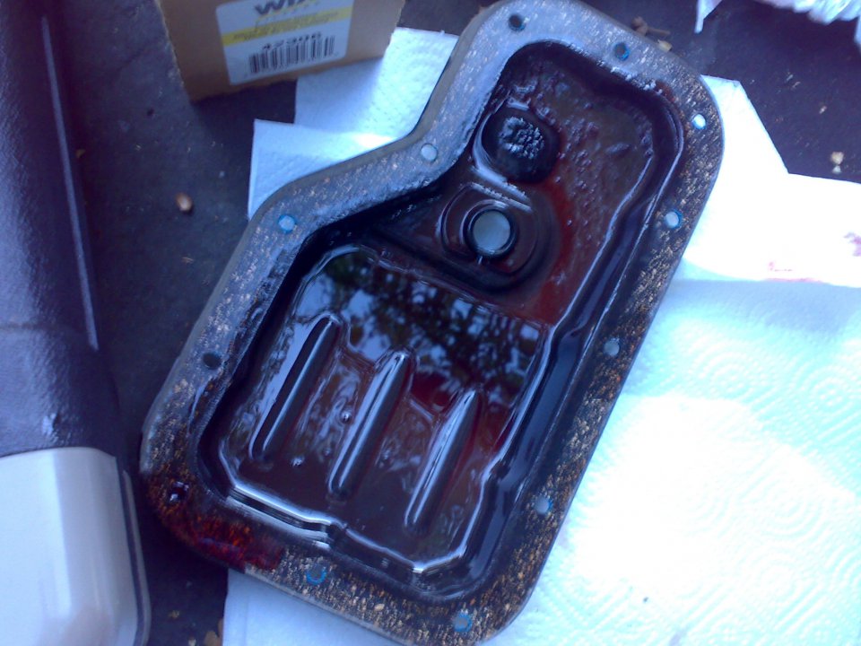

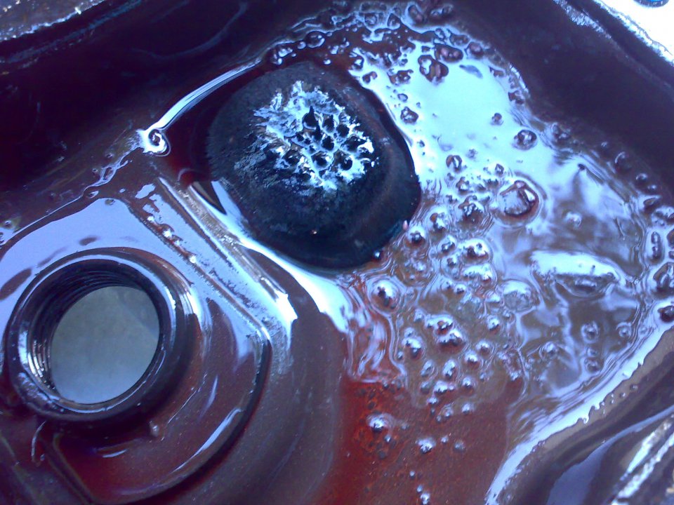

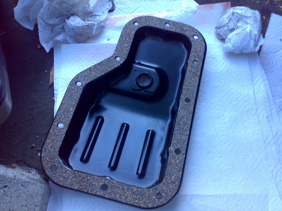

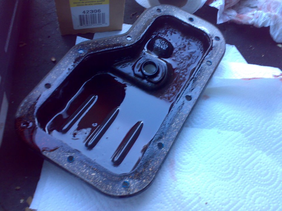

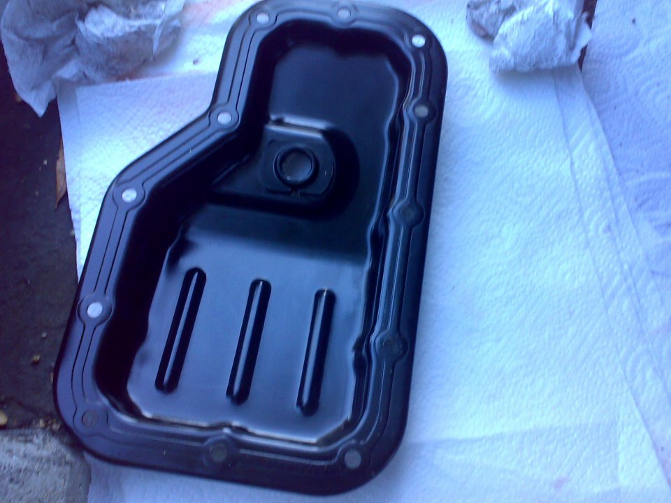

    prius with 153,000 mils, ATF IV was replaced by the dealer at 60,000, and at 120,000, by the book.
    Now it was done with dropping the pan due to the forum experts recommendations, and ATF IV by toyota.
    There was nothing to clean on the input screen, the ATF was still red after 33,000 miles.
    Yes, there was crud at the bottom and on magnet, but probably would not effect the transmission if the ATF is changed every 60,000.
    Maybe it's worth dropping the pan every 100,000 but not every 30,000 miles.

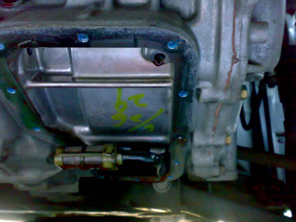

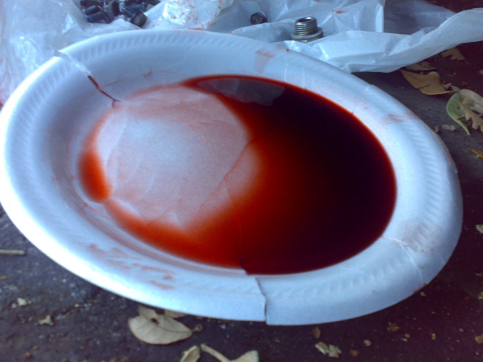

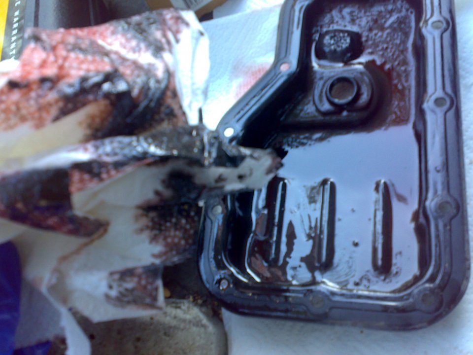

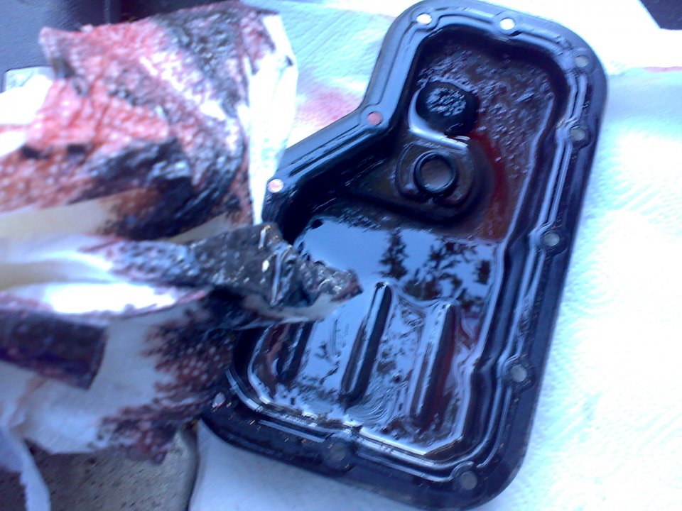

    Pictures for you analysis :
    Thanks!( I did not open this thread... )
    PS, how come the part above the input screen is not red from ATF?, it has some yellow writing on it and you can see it on one of the pictures, I don't understand how can it not be soaked in ATF, since this area is located under the filling screw level.
    Thanks

    If the screen has debris, it would mean some serious wear . . . gear and bearing threatening. Be happy!
    Oil analysis of the crud shows it is mostly sealant that had been ground up by the differential and chunks that didn't make it that far. It also includes the non-ferrous material. None of it is 'kind' to the transaxle.
    As for dropping the pan and cleaning, it is your car and your choice on how often. Since I get the oil and gasket from the same Toyota service center, it seems a small price. Having done it more than a few times, I find it 'no big deal' for a lot of peace of mind.
    As for the pool in on the foam plate, virgin Type T-IV is clear in a reused, clear water bottle. The stuff in that plate is opaque for a fraction of the depth.
    The ATF is not dyed so it won't stain. There would be a thin layer which could be wiped down. The lettering is new to me, the first time I've seen it.
    You did good!

    I am happy that you said that the foam plate picture can show that the AFT is not clear, I wasn't sure if those images can give good indication, anyway this car was serviced by toyota dealers according to the 60K miles recommendation, so I guess that driving 30K more with this dirty ATF would not do any good. I encourage people to replace it every 30K as people recommended on this great forum.
    I wonder if you or anyone can upload pictures of the pan and magnet after 30K miles of driving the car, BUT only if the pan and magnet cleaning was done prior to driving those 30K , if it looks the same as mine, then I guess that dropping the pan might be necessary every 30K because the magnet can only contain a certain amount of crud, but if it only has a little crud on the magnet, it might be fine to drop it every 60K or 90K.
