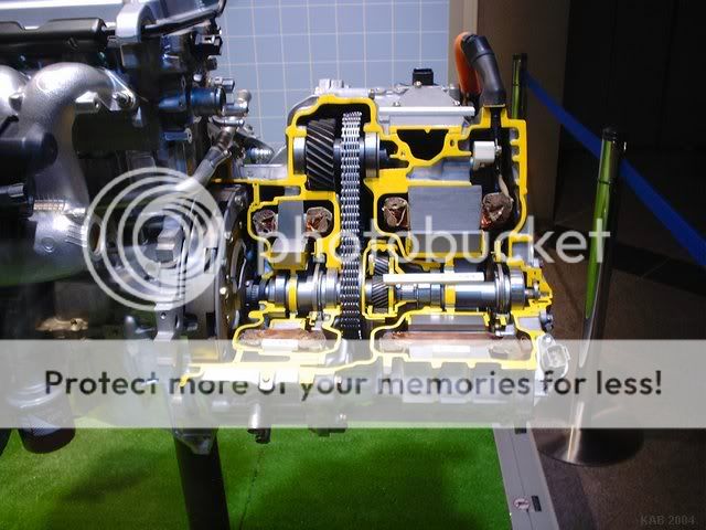

    The transaxle has two major component pieces, since it is primarily composed of two motor generators. The two pieces are like two slices of bread standing up.
    There is no need for a drain pan since there is no filter to be changed and according to Toyota, the transaxle ATF has no required change interval. However, as caring Prius owners, we like the idea of periodically replacing the fluid to get rid of the Si and Fe contaminants, and restore fluid viscosity.
