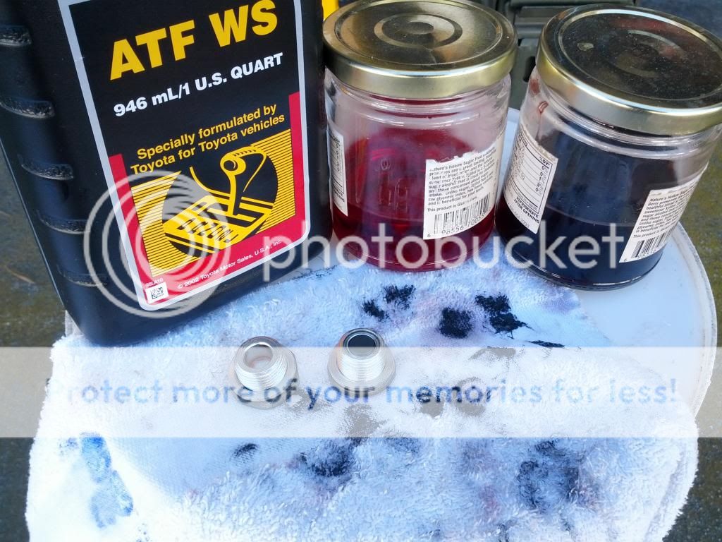

    That trans fluid is ever so slightly darker red, but after working on cars for years and doing many-a-transmission fluid changes, it looks great compared to what I drained out of the better halfs 2010 Ford Escape with 27k miles last week :eek:
    The fluid I drained out is, of course, on the right, new fluid on the left. NOW that is what BAD transmission fluid looks like!!
    Yours was a walk in the park, looking at it. Heck, most shops would still probably put your used fluid up on a shelf and use it as top-off on cars that come in!

    I grabbed an old Dawn dish soap bottle.... filled it with AFT fluid and sloooooooowly poured it into the tube until I had used about 3.5 qts and it started spilling out. This took about 25 tedious minutes and got a little messy.
    The drain plug was VERY hard to get off...didn't wanna budge....sprayed it with liquid wrench....used a regular ratchet with a pipe for extra leverage...ended up busting it free with a breaker bar.
    Fluid was Very dark and the magnetic drain plug had collected a good dime-sized dollop of goopy metal shavings that you can see all over the towel. (see picture I took).
