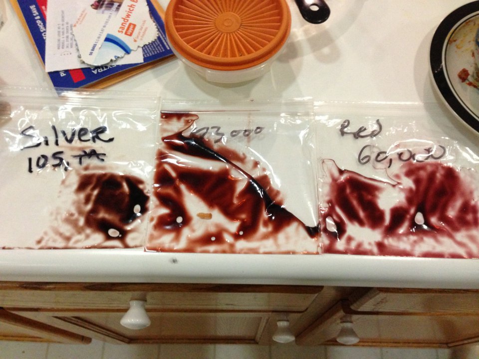

    Just did 3 of my 4 pri tonight, my silver car was bought used has 105,000 fluid was dark normal magnet fillings, tan prius was bought used has 83,000 fluid was not as dark normal magnet fillings, red prius was bought new we payed a dealer to change the fluid at 60,000 so this Change was a 60,000 mile change and the fluid was still red but darker than the new fluid. I would Say 60,000 miles is right on.

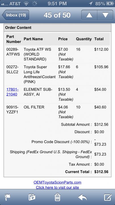

    Here is a bill from oemtoyotascion.com
    they have a special on parts purchases now free shipping on $300 dollar sales!

    Here is a photo of the fluids in ziplock bags! Hope this helps everyone.
    usnavystgc likes this.
