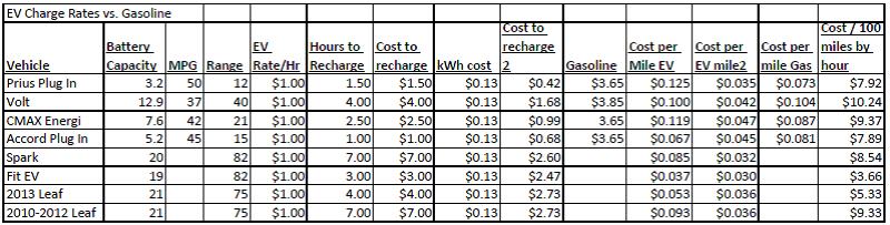

    I was performing calculations to try and determine a fair rate for the owners of our business park to charge for EV charging. In doing so I quantified something we all intuitively knew but it was stunning nonetheless.
    In some states you are not allowed to charge for electricity by rate or kWh. This leaves an EV charging station owner to charge a flat rate, charge nothing or charge by the hour. Charging by the hour can really screw up your financial calculations because some cars charge much faster than others on the same 240v source.
    For example, the 2011 Nissan Leaf has an onboard 3.3kW charger whereas the 2013 model has a 6.6kW onboard charger. Charge times in a 240v source drop from 7 hours to 4 hours. That essentially doubles the cost per mile for a 2010-2012 Leaf owner if they had to pay by the hour!
    For the Prius Plug In, the cost per mile for gasoline is so low that even at $1/hr for a 1.5hr charge is almost doubling the cost per mile. In this situation you are much better off just using gasoline. The Honda Accord Plug In has a faster recharge rate so it only takes 35min or so to recharge its slightly larger battery. In this case the $1/hr rate is acceptable for the Accord. * In the table I used Honda's claim for 1hr charge time despite what I've read on the forums.Here are the rough numbers I am working on. Please excuse the errors. I was only aiming for ballpark figures to show examples to our building owners. Cost to recharge = pay by hour. Cost to recharge2 = pay by kWh.

    I will use your chart for the EAA NY chapter as an example

    Anyone wanting to use the chart I posted should be advised that my numbers for usable charge and such are the best I could find with little research. Feel free to use the chart as a guide to develop your own chart with more accurate numbers. I won't be able to update mine until I get back to my computer on Monday.
