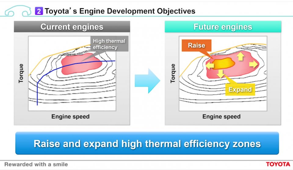

    What I mean is this.
    Take a look at this graphic from this Toyota video.
    If driving puts you in the lower-left corner because torque is really low, as it would be at low speed or on a gradual downhill stretch, charge mode could put you up closer to the red area. When I tried charge mode on a Prime, rpm noticeably increased, indicating to me that it tried to follow that blue curve up and to the right. If that thermal efficiency increase is sufficient to overcome the losses from generation and battery in-out losses, there could be an overall advantage. Of course, we'd need numbers of the above charts, and knowledge of the system losses to make that determination, and we have neither of those so this is just a possibility without testing.

    The yellow area inside the red one indicates the new +40% thermal efficiency (the "raise" part of the statement).
    This indicates to me that even if you are inside the red area but to the left to the yellow - charge mode will increase thermal efficiency, this may expand to 'moderate speeds flat ground'.
    I suspect that in charge mode the charge rate is constant (irrelevant of speed), so a simple test when the car is stationary may reveal this rate and the time required to charge from 'empty' to '80% full'.
